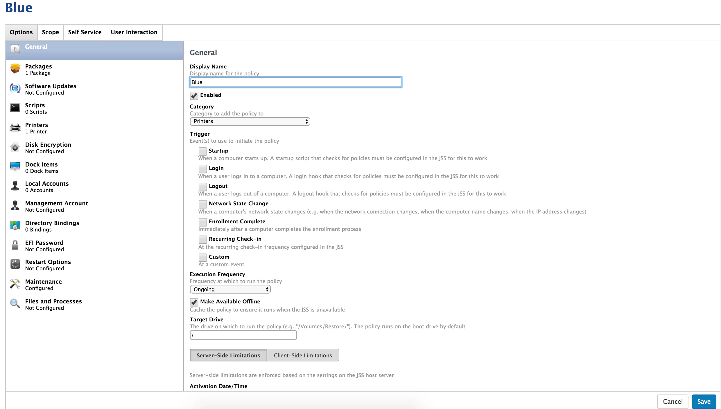

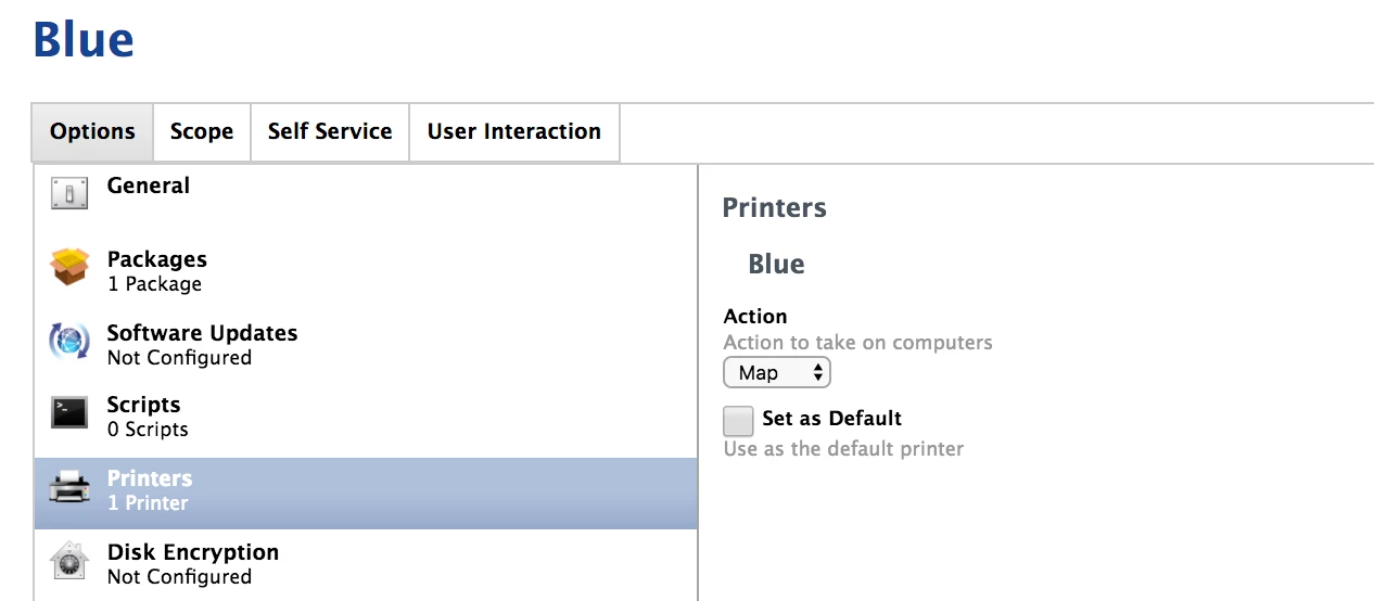

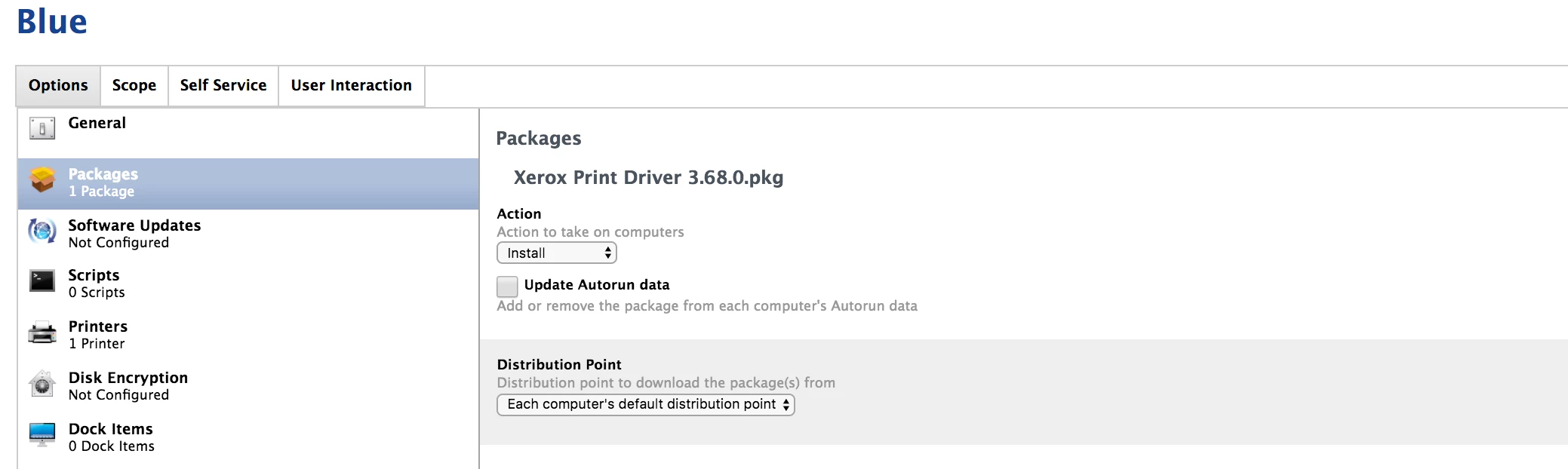

@WBS - I personally display all printers in Self Service and then limit them to Network Segments (Which are linked to Buildings) and that way when the users inventory updates their Self Service would only show printers relevant to them in that site. Package the Printer Mapping and Printer Drivers in one policy Scope it to All Computer and limit to the building or network segments you wish to.

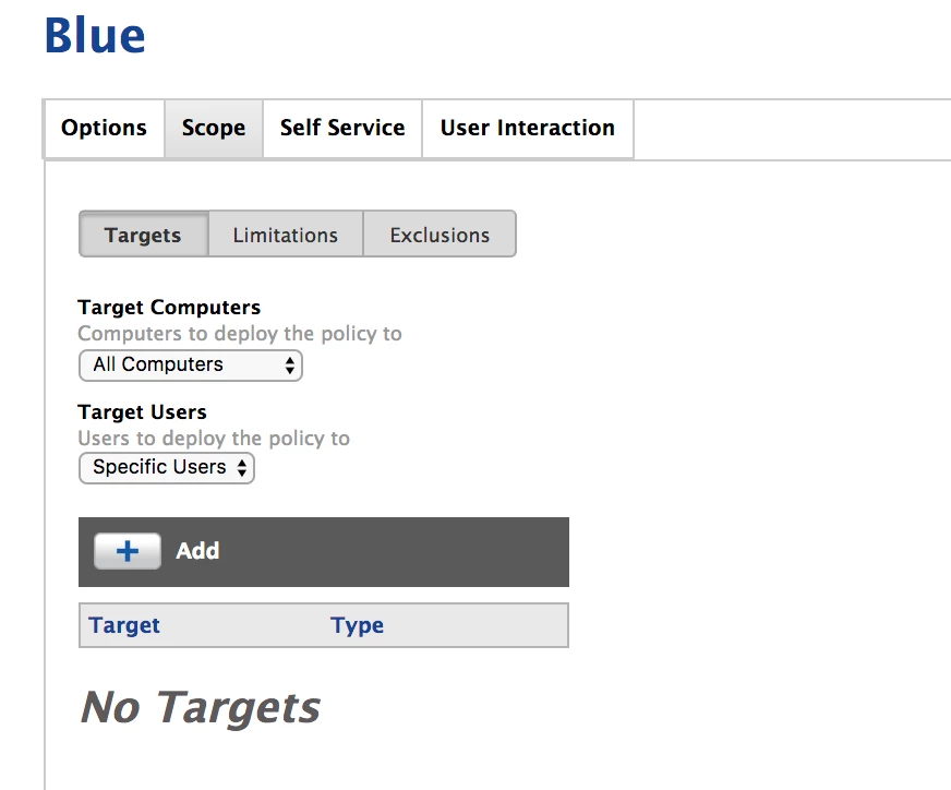

@WBS -

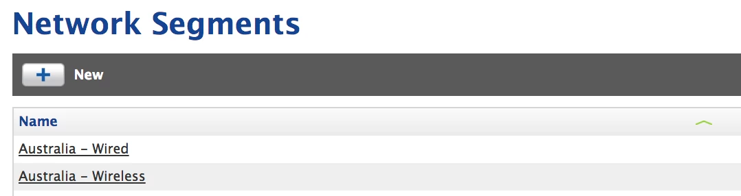

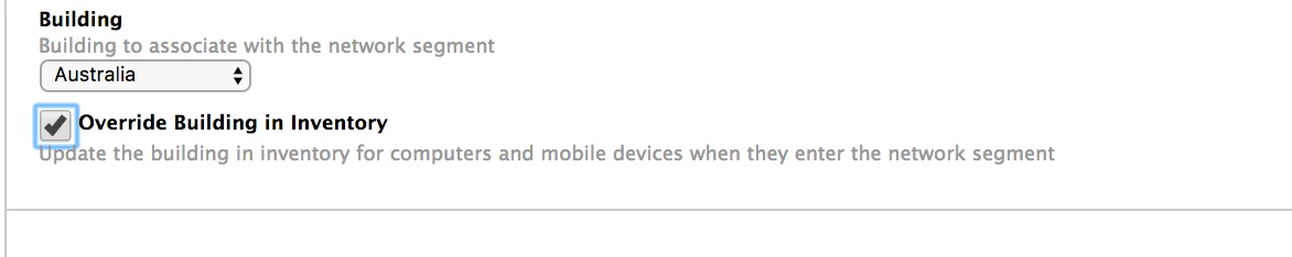

So i configured my network segments first...
Within the network segment specify any machines that meet the IP range fall into this building.

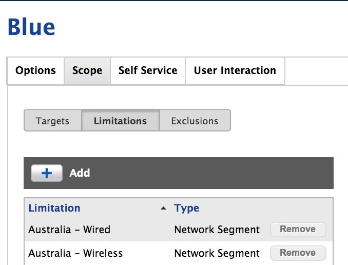

Then, make your Printer policy... i.e.
Scope is set to All Computers...
Limitations are limited to Network Segment
When a user is in that IP range, and Casper knows about it, Self Service will update and show you printers.
  • February 10, 2017
How often does it refresh the building i went through and alot of my computers are in wrong groups. However the segments shows its set to override but it must not be working right.
  • February 10, 2017
@WBS - When it does a recon/update inventory
  • February 10, 2017
I just looked at one that checked in 20 mins ago and update 25 and it still shows wrong location even though it has the correct IP to pick up the correct building. Any idea why? @Sachin_Parmar
  • February 10, 2017
@WBS - Could it be pushing that from LDAP? Any of your other network segments cross-over with the IP range you have configured?
  • February 10, 2017
Cant be any overlaps all of ours start with 172.16. ,172.18. or 172.20. for the locations the ldap i am not sure those arent even right alot of the ones that show up in 172.20. are teachers at 172.18.*
