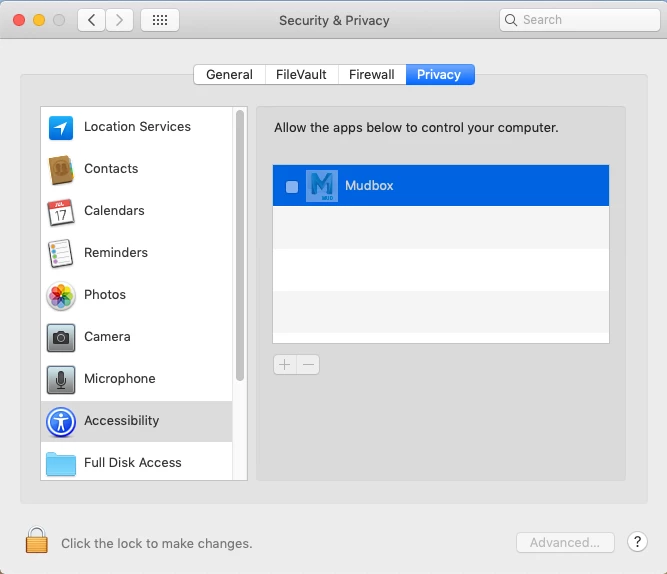

Hi,
I have managed to create and deploy Autodesk Mudbox and Maya 2019 Ok. This thread (https://www.jamf.com/jamf-nation/discussions/10267/packaging-autodesk-maya) was a massive help.
I don't know much about the software so had a bit of a play/test to see if all was working, as best as I could make out. All seemed to be Ok. A colleague then had a look and managed to get Mudbox to prompt a message requesting Accessibility control.
Having discovered this, I logged a support ticket with Autodesk who came back with this link to a similar issue with Maya (https://forums.autodesk.com/t5/maya-forum/maya-crashes-on-mojave/m-p/8340995) in that you needed to allow Maya control under Accessibility settings. This is a manual process.
Wanting to look into this from a large-scale perspective, I discovered that this apparently all came under the PPPC umbrella. I then downloaded JAMF PPPC utility where I created a configuration profile for Mudbox, uploaded to JAMF and deployed. However, where there had previously been a Mudbox entry listed under Security & Privacy > Accessibility, this was now not there with the apparent successfully deployed Config Profile in place?
What I would like to know is if this would be normal behaviour, or should it be that with the successfully deployed Config Profile there should be an entry present?
I am new to this PPPC stuff and my concern is that I have deployed what I believed to be a working App and now something it going to go majorly wrong on day 1 that it is required.
Any help or input would be most welcome.

IIRC, the PPPC profile doesn't actually tick the boxes under Security & Privacy. As long as the profile is setup correctly users should not get a prompt to allow/ignore.

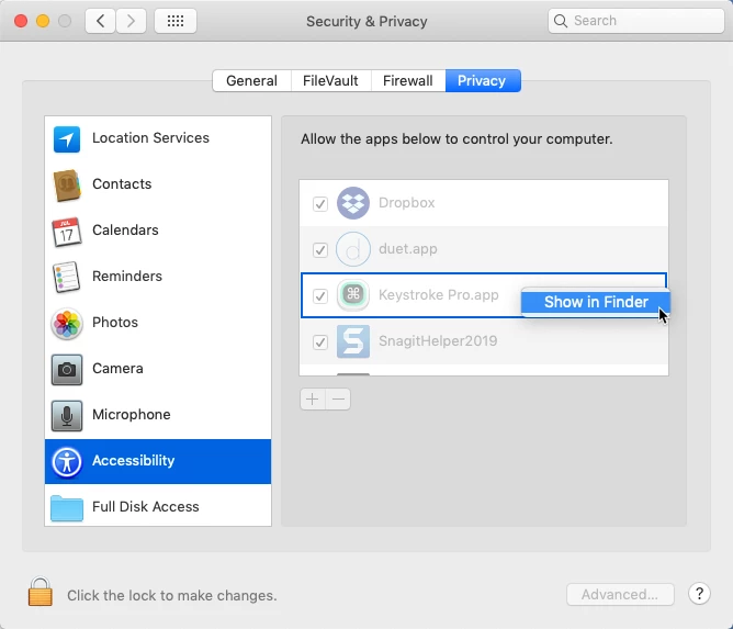

@SirSir is correct. Applying a Configuration Profile for Privacy Protection Policy Control (PPPC) doesn't change the appearance in System Preferences. Profiles override settings on macOS but they don't alter settings. If you remove a profile, the existing settings come back to life.
If you find you have a profile that doesn't appear to work, you may be looking as something like a sub-application (buried within the primary application bundle) or a secondary application that was installed somewhere else. For those, you can right-click or Control-click the requesting app in the list and choose Show In Finder to reveal it.
Use that to create your PPPC profile.
