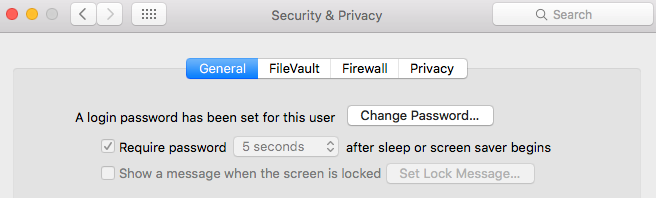

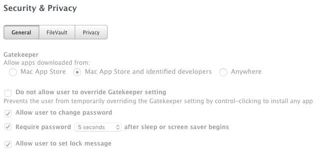

Hi,
We tried to create a policy for setting a password on a screen lock after 5 seconds and created a policy in Configuration Policies > Security and Privacy
However the Mac does not ask for a password after a user locks the screen or puts it to sleep.
If I remove the policy and set the lock-policy manually, it works fine...
What did we do wrong?

We are having this same issue. In our case it appears to be that the Login Window configuration profile has in its payload 'Screensaver ask for password = False'. This conflicts with our Security & Privacy profile that tells it to ask for a password immediately. Apple's documentation says that when two different profiles set conflicting data to one setting that it is left 'undefined'. I am not sure what this means but it leaves laptops unlocked.
Jamf's solution to our problem was to create a third profile and set this setting and install it using a package and the a terminal profiles command to install it. This does not always work in our case and a restart is known to some times make it stop working.

We just disabled the "Login Window"-policy and the password works fine again. What we are going to do is make a script with a few 'default write' commands.
let's hope JAMF fixes the issue in the next version of the Casper-suite (9.83 of 9.9)
