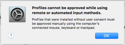

Profiles cannot be approved while using remote or automated input methods...
  • April 26, 2018
  • 26 replies
  • 161 views
Our users on 10.13.4 are getting the following message when approving their MDM Profile...
The problem is, there is no remote session going on. They are trying to approve the MDM profile while sitting right in front of their laptop, using it's own built in keyboard and trackpad. The only way we can get them approved is to login as root user and then it works.
Anyone else seen this and have a fix? I've already removed MDM profiles and re-enrolled into MDM and it makes no difference.
