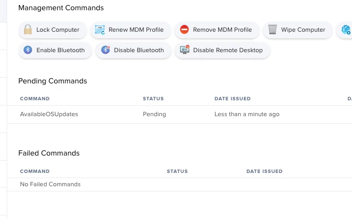

When I issue the command to an endpoint I see this in the console.
Then after a minute it goes away

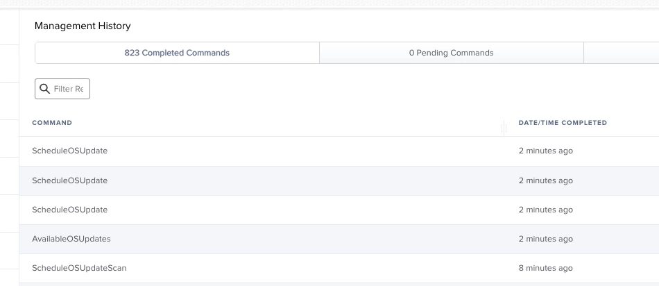

 then i see this in management history
then sometime over the course of the next hour, the update occurs.

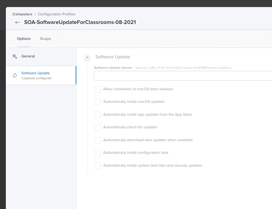

Thanks!  I appreciate your input!  Would you mind sharing your software update & deferment settings?  And, do you use NoMAD Login AD or Jamf Connect by any chance?  We use NoMAD Login and I'm starting to wonder if it might be getting in the way of updates at the login window?
  • Oct 6, 2021 6:40 PM UTC
We use plain nomad not the login variety.
Currently this is  how our classrooms are set.
And I have another custom deferment profile deployed to try to stave off Monterey from being automatically delivered.

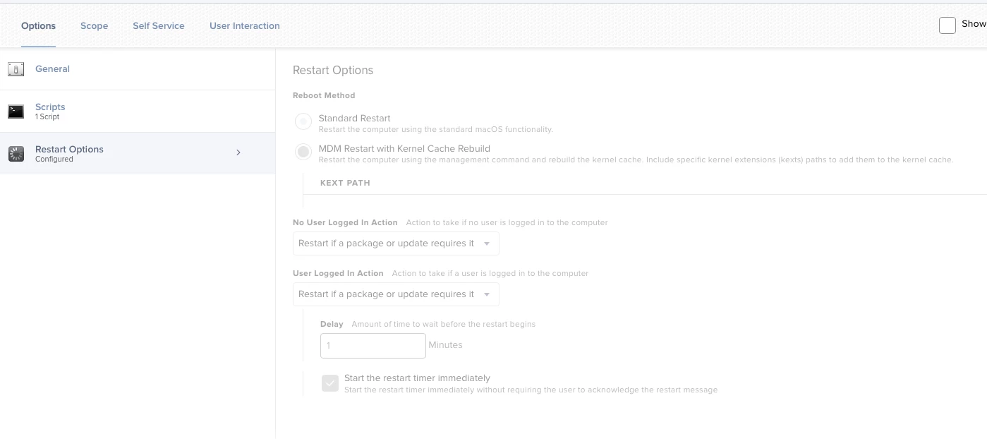

Thanks Tom!  My only thought is are you following up with a policy 'Restart Options' payload specifically set to 'MDM Restart with Kernel Cache Rebuild'?
I recently updated a few hundred lab stations to 12.3.1 at the login window so I know it's still working.  However as I mentioned previously, I almost always have a few stations that despite receiving the mdm command never complete the update!?  I suspect an Apple bug with softwareupdated, and lately I've been adding this earlier in the script. I feel like it's helping but I can't honestly say for sure.  The word is that Apple patched some issues with softwareupdated in 12.3 but I've not hat time to follow up & test.

Ah I did not have the restart payload set in my policy! Testing now, first computer did not work, will keep working on it. Using this policy with the "Enrollment complete" trigger so when when start getting new laptops ready, one of the first things that happens is updating to latest macOS.

@jonw actually it did work just now! Heading out for the wkd and letting another run now, will report back Monday.
