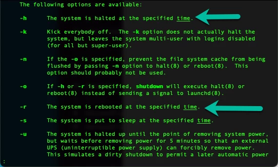

Thank you!  By the way, being new to terminal commands, exactly what is the difference between -h and -r?  I understand -r is to indicate recursion for paths?
bwoods
  • November 9, 2021
@KAndrews5725  here's a pro tip: whenever you need to know what the flags of a specific command do...you can open terminal and type "man + the command you need to learn more about"
In this case you would run "man shutdown" to learn more about the shutdown command.
  • November 9, 2021
Ok great!  Thanks again!
bwoods
  • November 9, 2021
  • November 9, 2021
I was looking at that, thanks!  So +1 indicates one minute.  So ideally I'd probably want "sudo shutdown -r +1 &"
