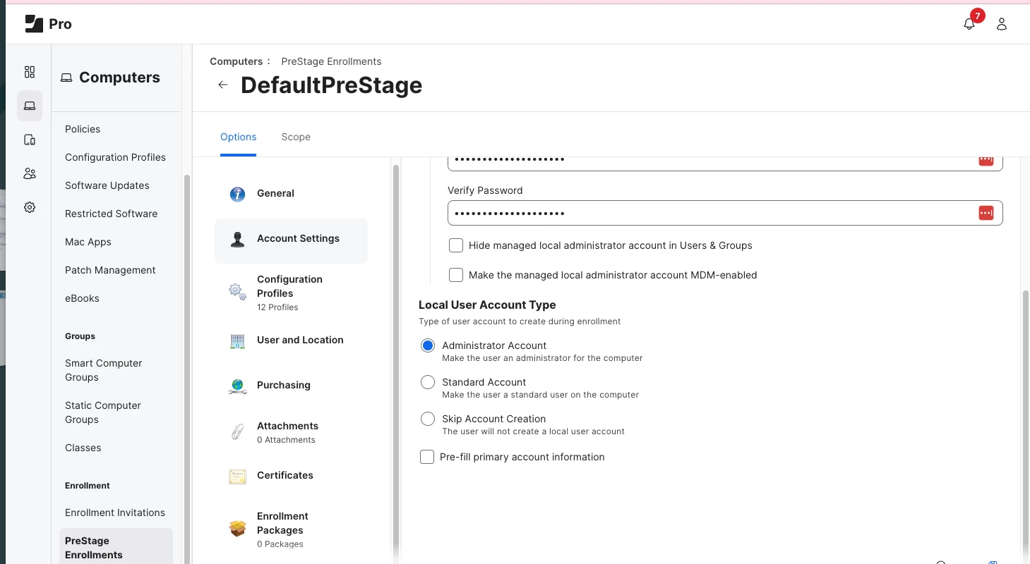

So just by running sudo jamf manage this will aid in correcting the Pre-Stage Enrollment new setting? I wouldn't have to run those commands? This is the new setting I'm trying to apply to all devices. ss. The new setting is the unchecked "Make the managed local administrator account MDM-enabled".
What is the purpose of making the accounts MDM enabled? As @jamf-42 pointed out, there is not a lot of reasons for having an MDM enabled account on macOS.
I have no idea. Mine was checked by previous JAMF manager.
