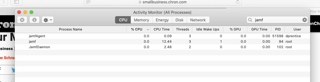

  • Jul 20, 2020 12:17 PM UTC
Good information guys, thank you all. I see a few processes in Activity Monitor. The Binary would be the one listed as just "jamf" right?
DBrowning
  • Jul 20, 2020 12:18 PM UTC
correct
  • Jul 8, 2021 9:32 AM UTC
Having an issue since Jamf Pro 10.30.3 where the Host Checker suddenly cannot find the JamfAgent process or the "jamf" process and hence does not allow connection to VPN.
We're a bit puzzled as to why a binaries update would break the Host Checker feature, since we are indeed able to see those processes running. I'll update here when we find out.
DBrowning
  • Jul 8, 2021 11:12 AM UTC
@tvalente 10.30.3 has removed the persistence of the jamf binary running. You'll need to look for jamfDaemon. This is what support told us and a lot of others. The removal was not documented in release notes. The jamf binary will only run when called now.
  • Jul 8, 2021 12:10 PM UTC
@DBrowning Thanks for your answer.
We've had more or less the same answer from support.
The JamfAgent daemon has been deprecated in 10.30 and will be fully deprecated in the near future https://docs.jamf.com/10.30.0/jamf-pro/release-notes/Deprecations_and_Removals.html the jamfAgent has had all of its code removed in 10.30. It's still on managed Macs and should still be running, but it does absolutely nothing.
We've switched to monitoring the existence of one Jamf's LaunchDaemons (/Library/LaunchDaemons/com.jamfsoftware.task.1.plist) since we found that using processes is not reliable.
