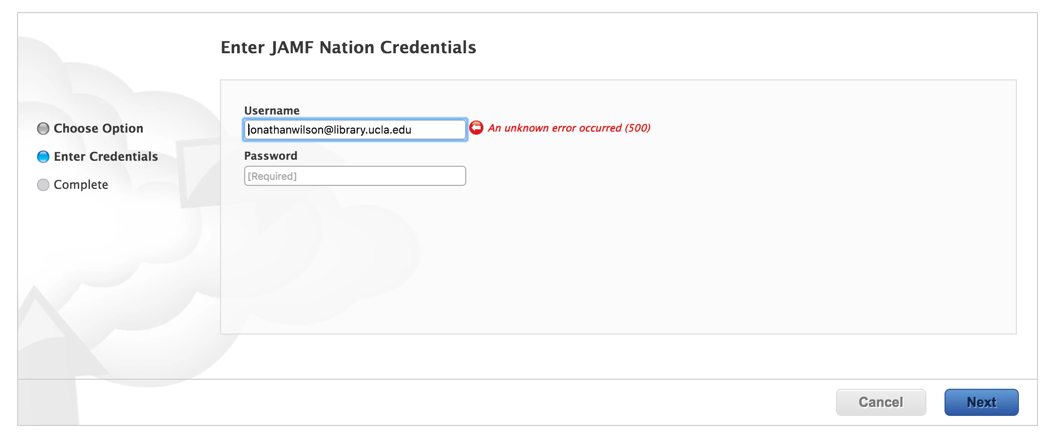

MbroCollAR's response seemed to be what my issue was, because I did, indeed, change my credentials recently, and it was my account that signed the cert originally. So, I deleted, and attempted to re-add, and this is what I get:
Any thoughts? I'll contact support, but figured I'd throw it out there.
  • October 24, 2017
I have the same issue and error message that jonathanwilson had. What is the cause and fix for the "an unknown error occurred (500)"

Add me as a third one to have this issue all of a sudden this week. Our token expired yesterday, I tried to manually renew it each time and the page would just refresh without doing anything. Jamf support recommended deleting the token and then requesting a new one, but as soon as I did that I got the same error message as @jonathanwilson posted above. Jamf support is now "investigating the issue" and will contact me once they have a fix.
