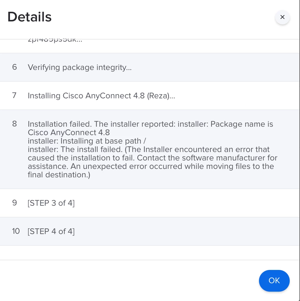

I have also tested the "New and modified snapshot" in composer and created it from scratch but when I try to install it through the self-service gives me this error:
Installation failed. The installer reported: installer: Package name is Cisco AnyConnect 4.8
installer: Installing at base path /
installer: The install failed. (The Installer encountered an error that caused the installation to fail. Contact the software manufacturer for assistance. An unexpected error occurred while moving files to the final destination.)
