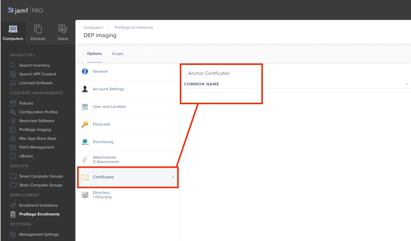

What's your DEP configuration? There's a number of posts around The Certificates payload and an Anchor Certificate. Do you have that configured? A number of posts indicated that having that payload causes issues, removing it fixes things.
  • August 16, 2018
If I let empty, I have a message "Failed to contact Mobile Device Management server".
When I put my internal root and intermediate certificates, it's ok.
But I have to create manually the first admin account and then no enrollment...
  • August 17, 2018
@glpi-ios Remove all payloads within the pre-stage bar the certificates and see if anything changes...
  • August 17, 2018
If you use a self signed cert on the server, and you have no load balancer with a third-party cert, you need your jss cert in there.
Try to create a brand new prestage, it will have your self signed cert in the certificates section by default. Then scope a device to that prestage, COMPLETELY WIPE THE DEVICE, then try to enroll it. If you take a device and attempt to enroll it, and make a change to the cert in prestage, you have to wipe the device in order for that change to take effect.

  • December 3, 2018
I'm running into something similar and am pretty confused here.
I'm using an SSL cert issued by our internal PKI. No matter what I put in the Certificates payload of the pre-stage (no certs, our root, or our root and intermediate), the enrollment fails during setup. It either says it cannot reach the MDM server or that there was a problem downloading the automatic settings.
When I bypass DEP during setup and run "profiles renew -type enrollment" it gives me the error about the certificate chain not being correct. If I manually add our root and intermediate certs to the keychain and trust them and try the profiles command again, it works.
Am I just banging my head against the wall because of a Jamf PI? I can't use the certificates payload, but can't do this without it?
  • December 3, 2018
@alexjdale, I had the same questions that you have about a week ago since i also use an internal ssl cert and was getting nowhere with DEP and the certificates payload, i kept getting "unable to contact the scep server" error when doing DEP, I opened a support ticket with JAMF and also talked to a few admins at the jamfnation slack channel and they pretty much confirmed that internal certs do not work/ not supported by Apple DEP, JAMF's support recommendation was to get a publicly trusted cert or possibly use the jamf built-in cert to avoid any issues. I'm in the process of moving our JAMF server to a public cert now that i know this information.
