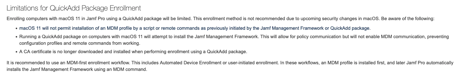

Has anyone been able to get QuickAdd.pkg to successfully enroll Big Sur non-DEP mac? The installers completes without any issues but no profiles ever get installed. Subsequent tries to re-enroll via the binary is unsuccessful in getting the MDM profile (jamf enroll -prompt).
However, installing via web enrollment works perfectly.
Could this issue with Big Sur blocking the ability to install profiles via shell?

I remember reading in the Jamf Pro release notes that quickadd package functionality was being reduced / deprecated going forward. The preferred methods are device enrolment or user initated enrolment.
Can someone clarify the correct method for this? When I send an enrollment invitation it downloads a quick add PKG which as discussed does not work.
@jcrain If you're not using Apple Business Manager/Apple School Manager and Automated Device Enrollment then you need to enable User-Initiated Enrollment and have your users on Big Sur enroll by going to https://YourJSSAddress.com/enroll
An additional advantage to user-initiated enrollment via the web site (/enroll) is that it grants supervision of the computer (like with DEP/ADE), which was never possible with QuickAdd packages.
If you have a previous workflow setup for Mojave you can just image it to Mojave and then push a script to install&upgrade to Big Sur.
In macOS Big Sur, the command line profiles Tool is getting a major version update, jumping to Version 8 from Version 7 deprecating the ability to install configuration profiles using the profiles command .
With the deprecation of the installation feature of the profiles command in macOS Big Sur, Apple has now made it clear that the Apple Mobile Device Management (MDM) protocol is now the only way to silently install configuration profiles on remote macOS machines.

You need to enable the User initiated enrollment for non DEP devices - Download and install the CA and MDM profile .
@vinu.thankachan Thanks for the info. However, we have enabled the user initiated enrollment for non DEP machines from Settings > Global Management > User Initiated Enrollment
But still our Big Sur machine is asking to Download the QuickAdd package which in-turn is not allowing MDM profile installation for the very well known reason. Any thoughts please?
