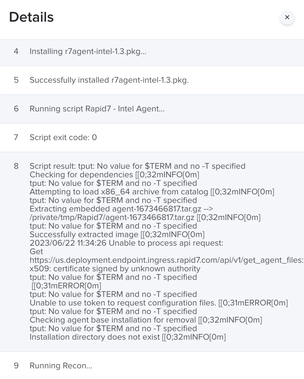

so here's is my conundrum: When I deploy my policy I am using a .pkg with dropping the agent_installer.sh in the correct folder, plus the uninstall command. Then I am running the actual install from a command in "Files and Processes" using the following command: sudo ./agent_installer.sh install_start --token xxxxxxxxxxxxxxxxxx. But when automagically deployed it doesn't recognize the command, however if I flush the log and then go into terminal and do a sudo jamf policy manually the policy works beautifully. Am I missing something?
I am seeing a similar behavior. When I run the policy via "sudo jamf policy" in terminal it works. But when I push it out to test machines and have it install during Check-In, I get this error when running the script "Script result: tput: No value for $TERM and no -T specified".
Hoping to find a solution..

Did not work for me. Had to cache policy, then install via script with the token.

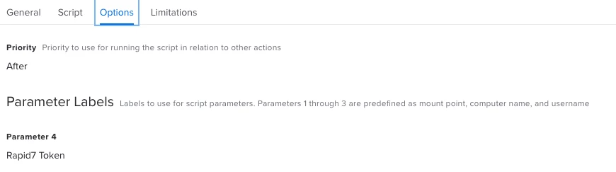

No, the script has to be in a directory on the Mac, e.g. /usr/local/bin/Rapid7/
I created a PKG which places both Rapid7 Installer Scripts in that place. In two seoarated Policies, one for x86 and one for arm Macs, I send the PKG to the Mac followed by the following Script which helps me to run the specified Agent Installer Script on the Mac:
#!/bin/bash echo "### Token: $4 #####" sleep 2 cd /usr/local/bin/Rapid7/ chmod u+x agent_installer-x86_64.sh && echo "### chmod done #####" sleep 2 cd /usr/local/bin/Rapid7/ ./agent_installer-x86_64.sh install_start --token $4 echo "### The following script has been executed: Rapid7-Agent-Installer-Preparation-x86_64.sh #####" sleep 2 echo "### List of /usr/local/bin/Rapid7/ $(ls -l /usr/local/bin/Rapid7/) #####" sleep 2 exit 0
The Script has the following options under Parameter 4 (I placed the Rapid7 Token there):
