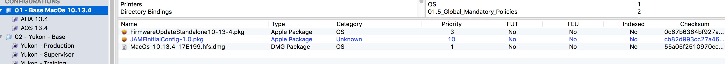

I re-provision (image) when ever possible for this scenario..
I personally am statying away from APFS - but my workflow once I get it to the OS Files to JCDPis basic
Since you are upgrading older devices you have to extract the firmware and add it as a package during imaging. You do not have to upgrade then wipe to get firmware. Graham Gilberts script is available here: https://github.com/grahamgilbert/imagr/wiki/High-Sierra-Notes
I am rambling and it i s late at night but I hope some of these tidbits are useful.
