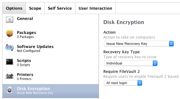

I was reading this thread closely as I want to re-issue individual keys with frequency, but I'm finding on initial tests that using the native JSS options are working fine, as opposed to scripts and profiles.
I'm confused on the last item though, Requires FV2 At next login. I'm seeing the key rotate immedaitely. Regardless, I'm considering running this as a weekly policy to ensure that if a key is used/viewed, it will be rotated within a week.

I think this thread is primarily for situations where the keys may go missing due to DB corruption, migration to a new DB/JSS/etc. The "require" field you mention is for situations where FV may have been turned off or not activated yet.
As far as scheduling goes, I personally would say that's overkill. What might you be gaining by doing this? If your keys are being accessed, that's when it would make the most sense, right?
