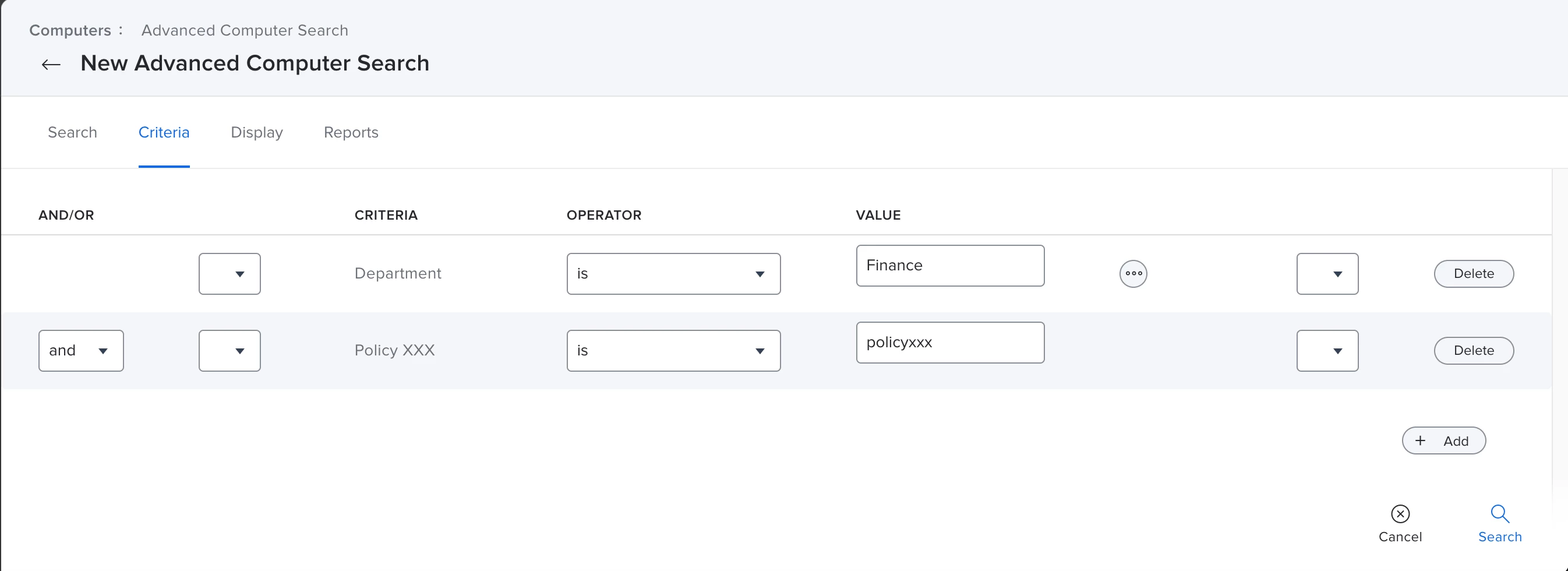

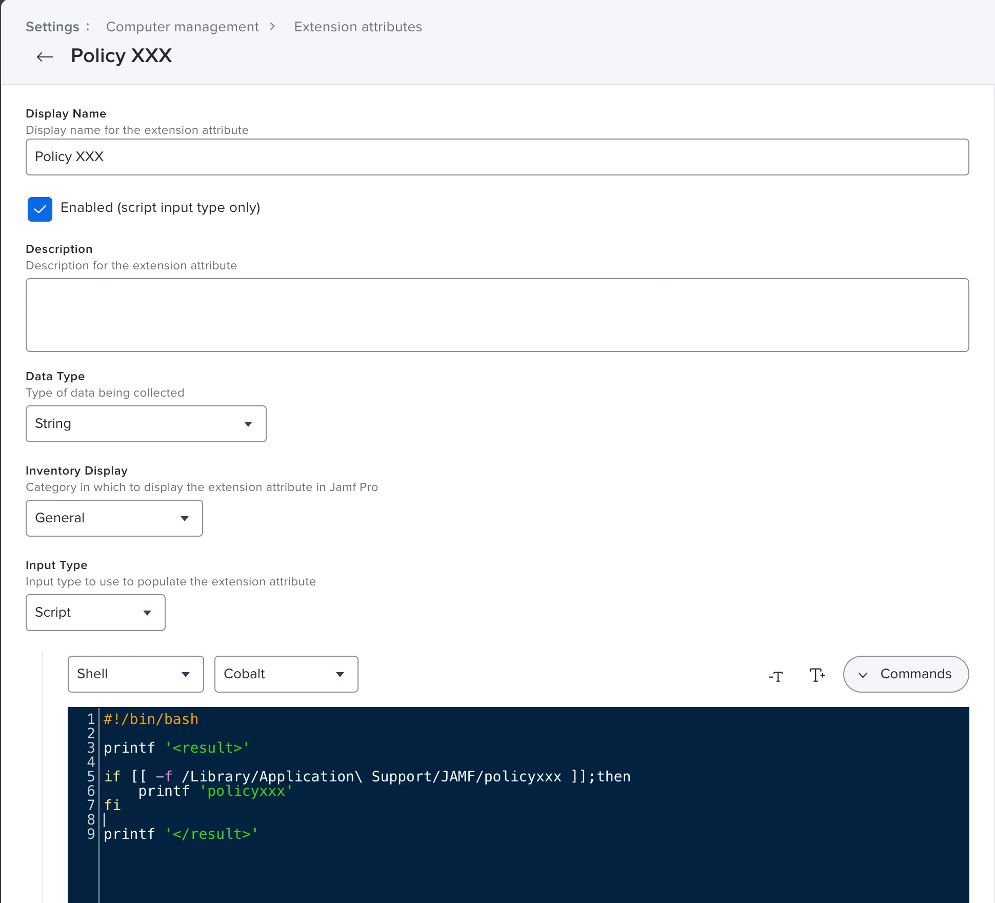

Like most everything with Jamf, there are a lot of ways to climb a tree, but here's one idea - you could add something to the policy that was a marker.
A one liner like this in the files and processes/execute command field (obviously change the policy name to something meaningful).
touch /Library/Application\\ Support/JAMF/policyxxx
Then create an extension attribute script that looks for that and returns a result you can search against.
#!/bin/bash printf '<result>' if [[ -f /Library/Application\\ Support/JAMF/policyxxx ]];then printf 'policyxxx' fi printf '</result>'
Then use a smart group or a saved advanced search based on department and the extension attribute having that marker.
Or you could for instance create a group that didn't thave that marker and use it to run the policy... so many ways to extend it.
And if I can give you a tip on the re-scoping... in short, use the APIs. ;)
