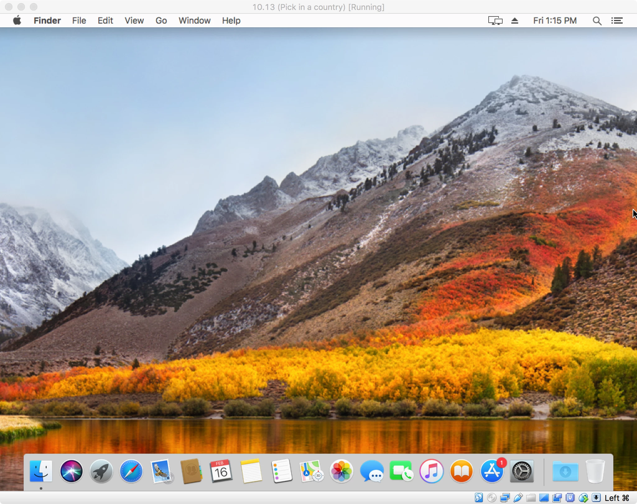

I am running a new 10.13 VM in Oracle VM VirtualBox, its freeware. Their latest release is version 5.2.6.
Once you run the quick add pkg. the JSS picks up on the VM machine and it works well!

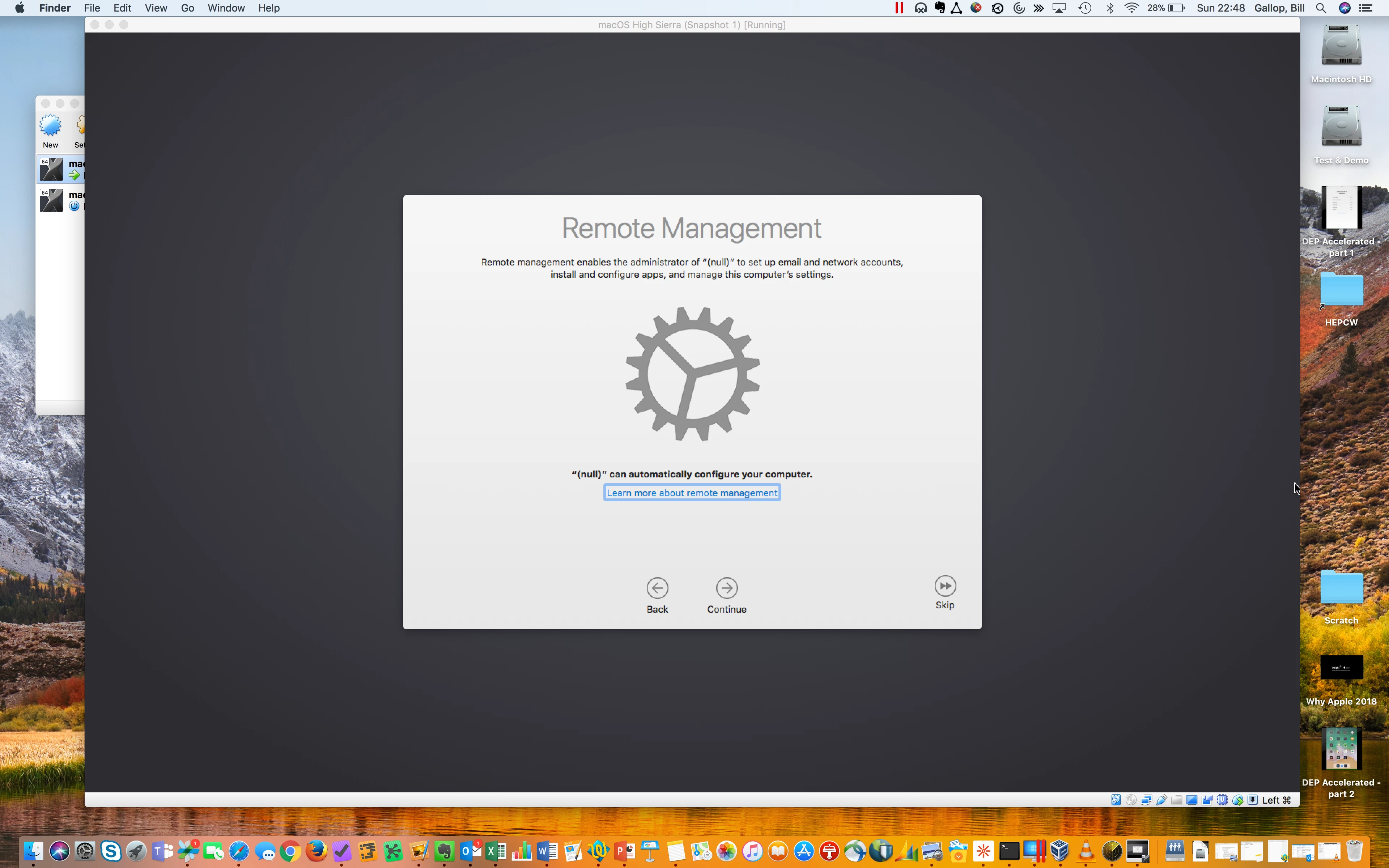

I'm a little bit further along than adaraghmeh. I have the VM talking to DEP, it gets the PreStage Enrolment but then it fails to pull down the profile as it says that (null) wants administer it
If I skip the enrolment the OS can access the internet but refuses to connect to the JSS at all, it can resolve the DNS entry for the JSS but refuses to ping it by either FQDN or IP address.
Something, somewhere in the network configuration is stopping it getting to the JSS
@BillGallop Is this virtual box too? Have you tried VMWare?
@bentoms works fine in Parallels so I know the server end is fine, something funky at the VirtualBox side. I'm needing to use VirtualBox as I want to do some recordings of the DEP deployment for a presentation and with VirtualBox I can set the resolution of the VM to something 16:10 whereas with both Parallels and VMware I can only do something other than 1024x768 once I've got the OS up and running and have installed the relevant drivers for the virtualisation app
