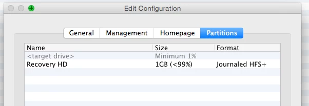

I use a script as part of the Recovery HD config.
/usr/sbin/diskutil unmount /dev/disk0s3
/usr/sbin/asr adjust -target /dev/disk0s3 -settype Apple_Boot
This is my main Config setup (OS & Apps, etc)
This is my Recovery Partition Config
Hope that helps!

It looks as if you created two separate DMGs for a base image. One with the OS(without a Recovery) and the other with just the Recovery Install. You then create a partition on the install configuration in Casper Admin and place your Recovery Install in the partition along with this script(You create as a policy in JSS). Does this about sum up the procedure? What is the purpose of the script, please?
@stevevalle That's the process we currently use, but the script you, and JAMF, prescribe is only to hide the Recovery HD partition in Finder with the Mac fully booted, not to hide it on the Option-Boot screen.
