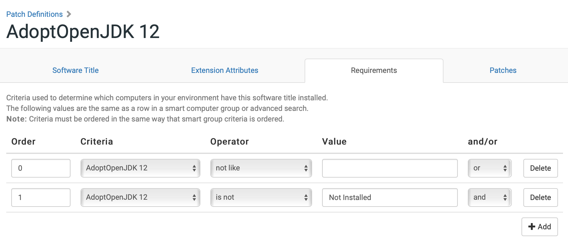

I am using our patch definition server to track OpenJDK Installs which I have setup with an EA that has been set not to match blank spaces as a requirement..

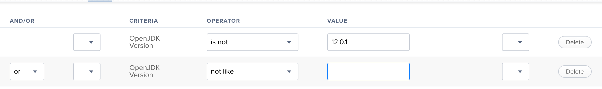

So with my Smart group which is similar to yours I still get devices with a blank field in the group
I need a way to say IF you contain numbers AND are less than 12.0.1 for the criteria

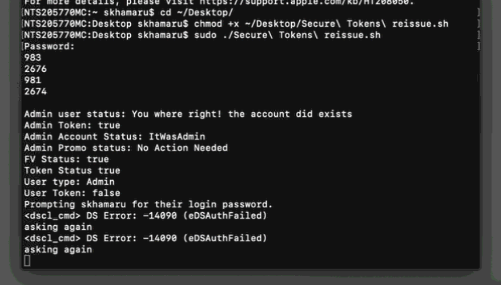

mani2care
  • October 2, 2020
@stevewood thanks got it can try this script and catalina not working can able to help.
https://github.com/TravellingTechGuy/manageSecureTokens/blob/master/manageSecureTokens.sh
stevewood
Forum|alt.badge.img+38
  • October 2, 2020
@mani2care
Typically DS Error type errors are because the domain cannot be reached. I believe you need to be on a network that can connect to the domain controller to run that script. I haven't looked at that script. Make sure you're on the network, either on the acutal network or connected via VPN.
