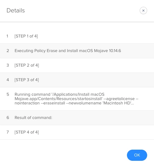

Still hanging. Not working :(

This is mine, obviously ignore the fact that it is for Catalina, but it has worked for me consistently. It was modified from Mojave which also worked for me.
'/Applications/Install macOS Catalina.app/Contents/Resources/startosinstall' --eraseinstall --agreetolicense --forcequitapps --newvolumename 'Macintosh HD'
  • December 10, 2019
Found one for Mojave
'/Applications/Install macOS Mojave.app/Contents/Resources/startosinstall' --agreetolicense --nointeraction --eraseinstall --newvolumename 'Macintosh HD'
  • December 10, 2019
Thanks! Appears to work now. Trial and error! @talkingmoose

Spoke too soon. Did not work on second identical iMac. Policy log looks good though.

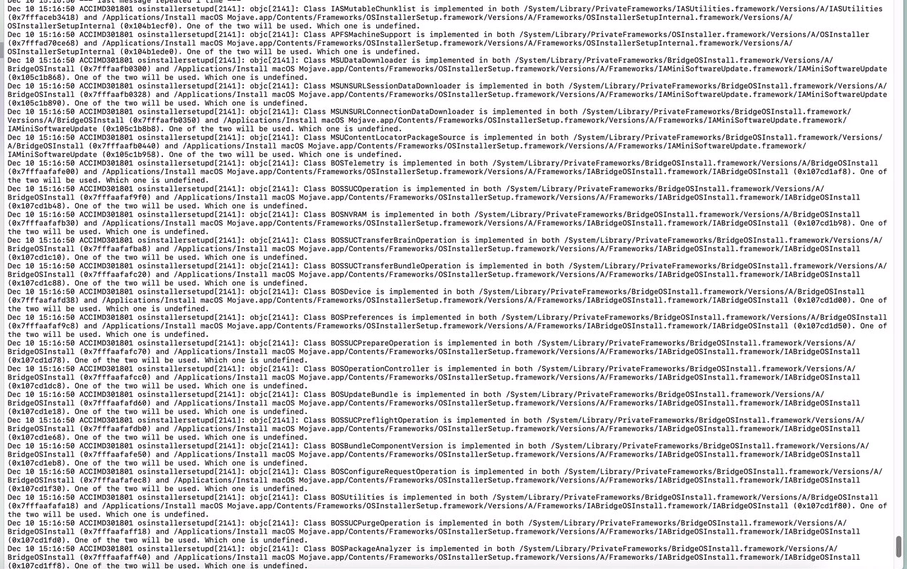

system.log
  • December 10, 2019
Dec 10 15:21:03 xxxx osinstallersetupd[2331]: objc[2331]: Class BOSError is implemented in both /System/Library/PrivateFrameworks/BridgeOSInstall.framework/Versions/A/BridgeOSInstall (0x7fffaafb0170) and /Applications/Install macOS Mojave.app/Contents/Frameworks/OSInstallerSetup.framework/Versions/A/Frameworks/IABridgeOSInstall.framework/IABridgeOSInstall (0x103ba62c8). One of the two will be used. Which one is undefined.
