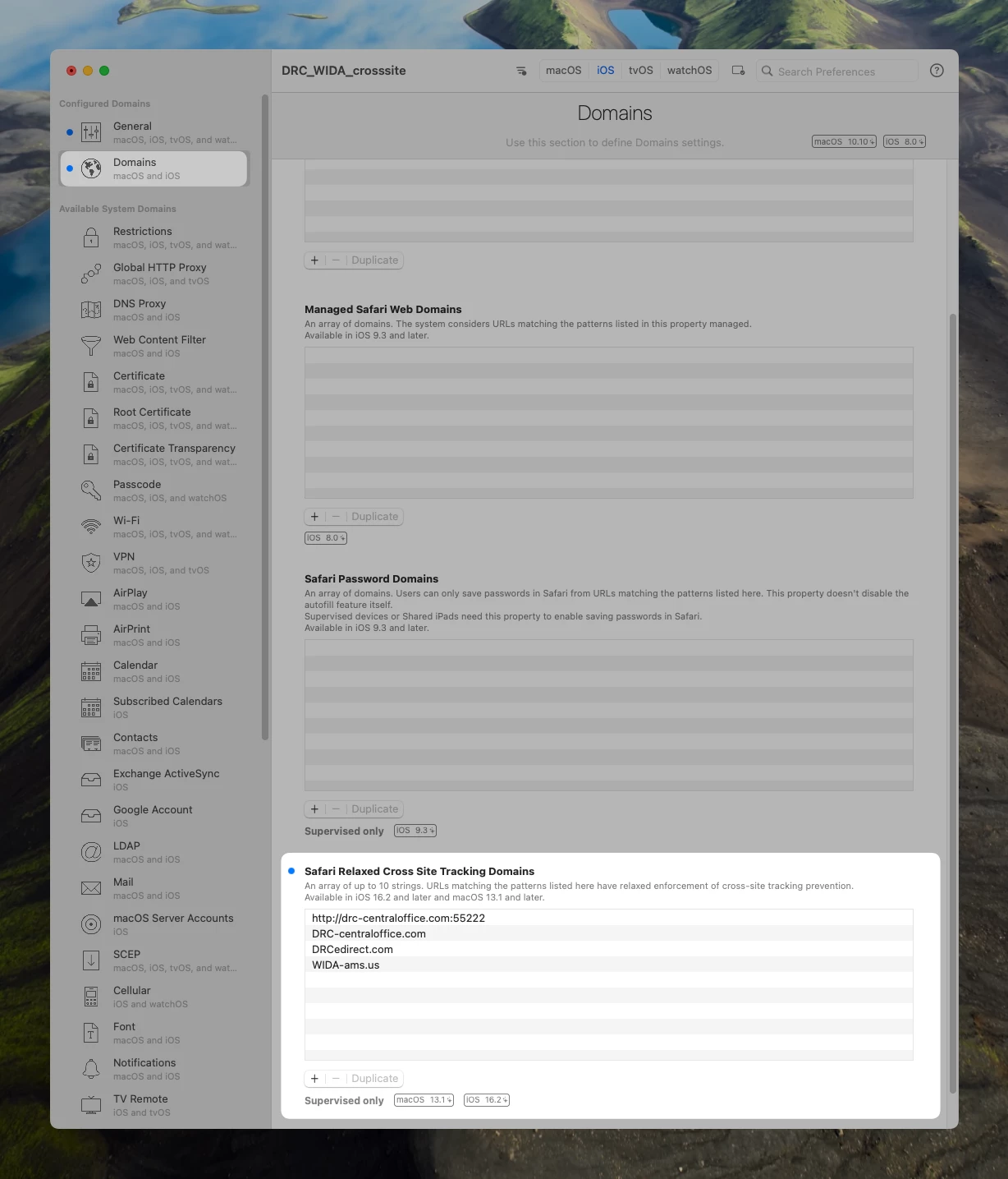

I used iMazing's Profile editor to create one, even though it's very simple as it had the "Relaxed Domain" category that Jamf Pro is missing from its domain section.

So I have just found this thread and I am trying to do this as well and I can't with Jamf Pro. Attached is what I have added to the App Configuration. The Org ID comes to the iPads just fine. But it does not seem like the URLS are being added.

I did download the iMazing and added the URLS. When I upload the config profile I do not see them as apart of the configuration. We are trying to get this to work as we test from grades 3-12 and probably about 1500 iPads that need the toggle turned on. This would just help us alleviate a headache for ourselves as well as teachers and students trying to test.
  • Dec 11, 2024 4:02 PM UTC
Are you looking for it in the app config? or in the device management on the device itself?
  • Dec 11, 2024 5:15 PM UTC
That was a my bad never checking the device itself. I do see the config profile and has the URLS listed there. I am still getting an error saying that content couldn't be retrieved. I have whitelisted all 4 domains as well in content filtering. I am unsure of what to try next to get this working.

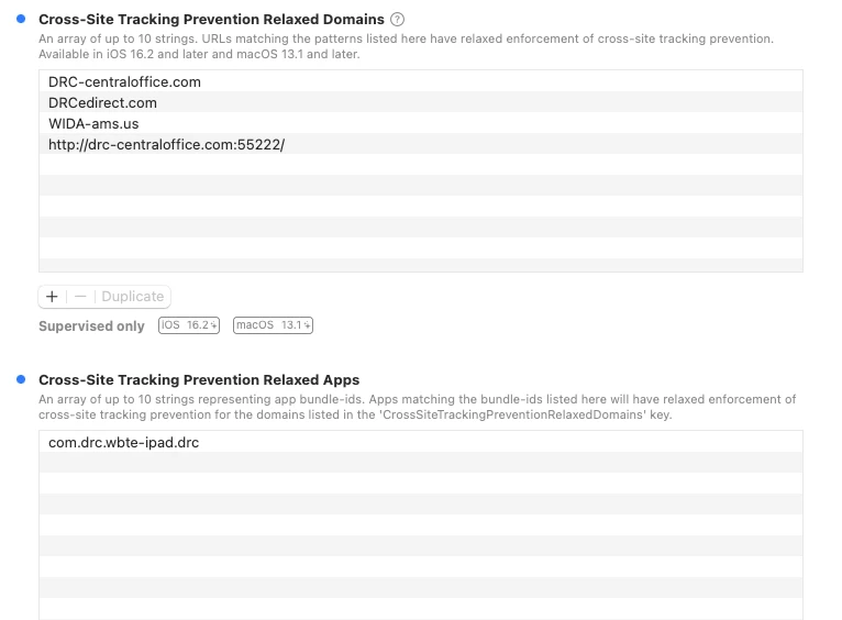

Hello everyone,
I was successful in getting this to work. See the attached screen shot, it shows how we had to set it up with Jamf PRO and iMazing Profile creator. This was the response from DRC in my help ticket with them. Also attached below is a screen shot of my iMazing profile I uploaded to Jamf PRO.
You mentioned allowing "domains,"  please allow the specific URLs on those allowlisting tables from both the WIDA and Pennsylvania Technology User Guides (links provided in previous email) to be as specific as the DRC allowlisting tables specify.
Additionally, I came across this information from another user who was having a similar issue with getting his MDM to properly control their iPadOS 18.1 iPad's Cross-Website Tracking--maybe it will work for your MDM & iPads.
He said, "After adding the new key below to the mobileconfig file, we were able to log into WIDA DRC Insight without error, and did not have to manually enable the “Allow Cross-Website Tracking” toggle on each iPad.
<key>CrossSiteTrackingPreventionRelaxedApps</key>
<array>
<string>com.drc.wbte-ipad.drc</string>
</array>
  • Dec 17, 2024 2:58 PM UTC

I am not finding the key for Cross Site Tracking Prevention Relaxed Apps in iMazing.
  • Dec 17, 2024 4:29 PM UTC
I am not sure what to say as that is what I used. I am running version 1.9.2. Maybe it needs an update. I also had the profile saved and reopened it and appended to it.
  • Dec 17, 2024 4:54 PM UTC
My app was up to date but the Preference Manifests were not.  After I quit the app a few times I got the pop up to update those lists. Now the key appears in Domains. Will give it a try again

Hello everyone,
<array>
</array>
