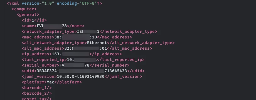

JAMF does gather IP address with inventory updates, the IP is in the computer General tab. Collecting the IP Address and Reported IP Address in Jamf Pro - Technical Articles | Jamf
Putting credentials in a script, its not secure at all. Scripts stored on the device are in plaintext. Scripts sent from MDM can be intercepted by applications like WireShark and have the contents read.
If it was me doing this, I would have whatever tool you need to have the device IP information use JAMF API to pull the inventory record's and ingest the IP address. Assuming having the data in JAMF is not sufficient.
