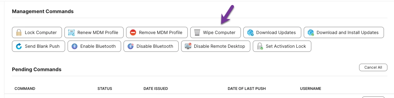

You got yourself a good-looking script, however Apples recommendation is to wipe a device when it changes hands.
What to do before you sell, give away, trade in, or recycle your Mac - Apple Support
I would suggest simply using the Wipe Computer MDM Command in JAMF. It takes about 30 seconds to hit the device, and the data is sanitized (crypto erased if FileVault is enabled). Apple Silicon Macs take about 5 minutes to set up after the command is received. Intel Macs need an OS reinstall, but it leaves you in recovery.
Thanks AJ,
This script applies to students that wish to retain there data in place and it is a more flexible solution to offboard 200+ devices without wiping them, this logs the results in a google doc and the renaming means we have the historical records going forward without a licence.
We do in fact use your suggested method in another script to wipe spare devices, primarily due to onboarded staff and students throughout the year.
