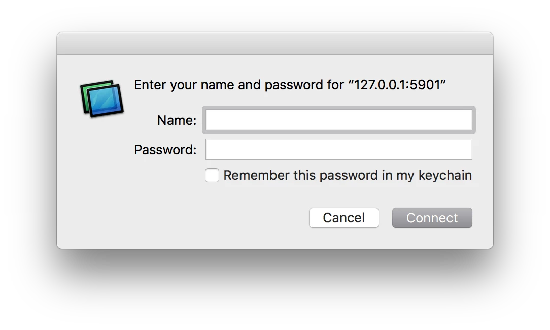

Once you have initiated the SSH session, go to Finder > Go > Connect to Server (or  + K from the Finder) and open a VNC connection to port 5901 on your local mac:
vnc://127.0.0.1:5901
You will then be prompted with a login username and password prompt. This is where you enter the admin credentials of a remote login capable user on the client's machine.
Once you have completed the remote session, go back to your terminal where you initiated the SSH session on the admin side and run sudo killall sshd. This will kill the sshd process and terminate the connection for you and the end user. Don't worry, Linux takes care of starting it back up again in preparation for the next remote session.
