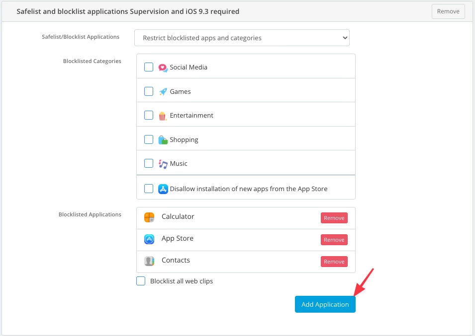

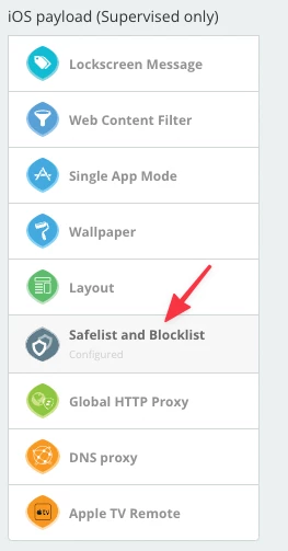

If you want to remove the built-in app such like Calendar, Messages...etc you need to use the "Safelist and Blocklist" payload in Jamf School Profile.
Actually we just hide the built-in app in the iOS devices
And then you can add the application that you wouldn't let the user to use.

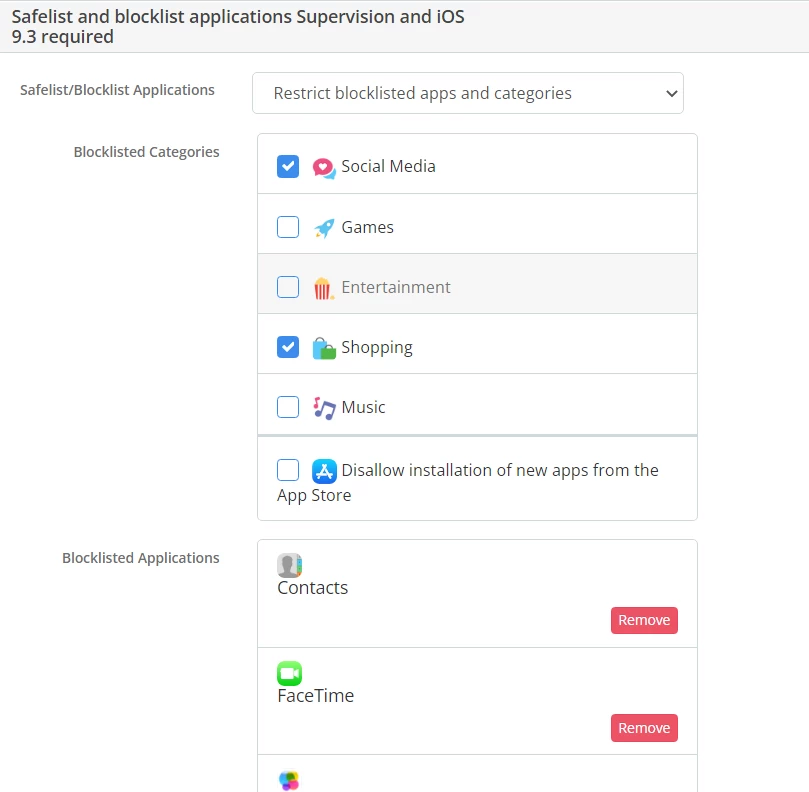

I was convinced that would work making these changes (I added all the apps mentioned above):

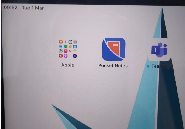

However, having re-sync'd and left it for 30 mins I still have this app collection on my iPads:
And all the apps are available to be used :-(

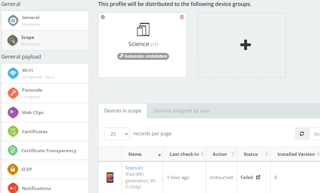

I 'have' but when I was getting a pic to show you I see that the last action on these iPads is 'failed'.  Is that something to do with it and how do I chase that down?
The first thing I would try is to reinstall the profile to see if it was a fluke. If you click on the device name you can get to the Device Details page. Go to Managed Profiles, find that profile and push the Reinstall command. If it fails again, then something may be off. The message you get from clicking on the Failed status may give some information.
To troubleshoot this further, you should try making separate configuration profiles to test where it is going wrong. Best practice is to combine as few profiles as you feel comfortable with to avoid situations like you are experiencing. For example: have separate profiles for Wi-Fi, Passcode, and Restrictions. It will also help if and when you have to change a setting without affecting the rest of the profile.
Also, this might just be me seeing ghosts, but I noticed you have a Passcode payload for your profile. I've experienced issues with profiles not installing with a conflict between the Passcode and Restrictions payload. If you have a Restrictions payload on the device as well, check to see if you have "Allow modifying passcode" disabled. Having the Passcode payload configured as well as disabling "Allow modifying passcode" in the Restrictions payload causes a conflict (there is usually a notification that fades away pretty quick).
I hope you find this helpful.
I would recommend to separate the profiles, every aspect should have its own profile. And what is the failure message? You should be able to click on the Failed Button, to get a detailed message.
