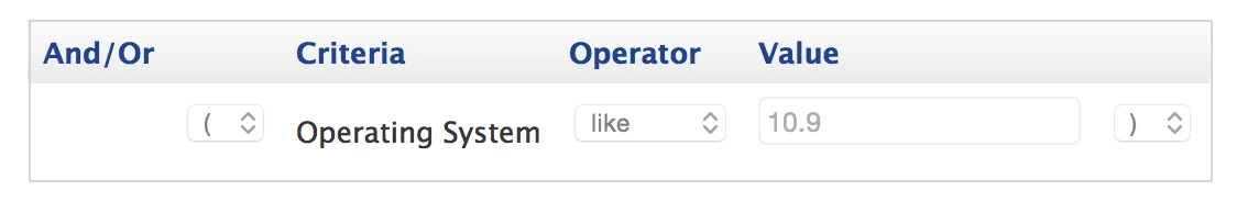

Any urgent help would be awesome! I have a smart group already for 10.9 machines, created a policy to send them the 6.5.3 package but they all failed, i guess as it has 6.6.1!!
My criteria seems fine, just need to get 6.6.1 removed first and then install again through policy!
