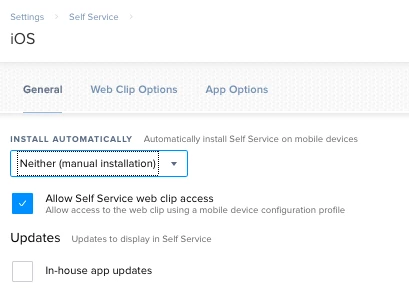

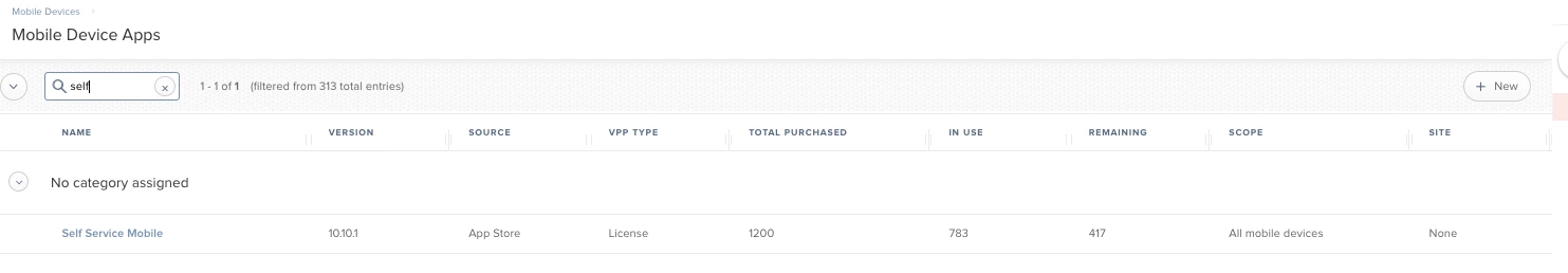

@Lucasder The only thing you are missing is to purchase free licenses from VPP for Self Service, and edit the app to use the licenses as device licenses (VPP -> Assign VPP Content) (scope the app to All Devices). This will remove the prompt for iTunes. Also, you do need to choose 'Neither' for automatically assigning Self Service like the picture in the previous post, so the web clip comes off.

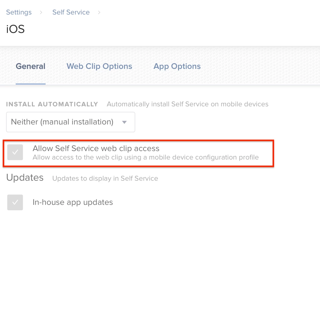

I spoke with support yesterday and we came to the conclusion this is a product issue. In the screenshot, you can see it is set to neither, and below it the box is checked for "allow self-service web clip access." That checkbox is the issue, even if you uncheck it and then save it will remain checked and not remove the web clip version of self-service.
