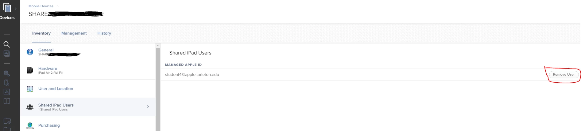

  • January 3, 2018
Is this what you're looking for? It's under Inventory, Shared iPad Users
If I understand it correctly, this will delete all of that user info from that particular device.
