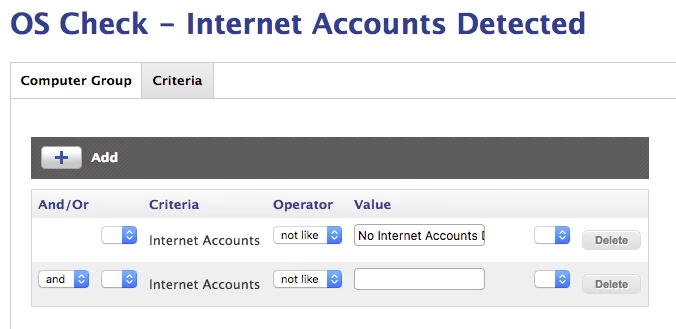

apizz
Forum|alt.badge.img+15
  • Jan 31, 2017 8:00 PM UTC
Went one further, and created an extension attribute which reads all users' ~/Library/Accounts/Accounts3.sqlite file if it exists, reads the data, and prints to an array for reading by the JSS (so long as the array is not empty).
EA:
RESULT=()
for USER in /Users/* ; do
    if [ -f "$USER/Library/Accounts/Accounts3.sqlite" ]; then
        INTERNET_ACCOUNTS=$(sqlite3 "$USER/Library/Accounts/Accounts3.sqlite" 'SELECT ZUSERNAME, ZACCOUNTDESCRIPTION FROM ZACCOUNT' | tr '|' ' ' | awk NF | tr ' ' '|')
        if [ "$INTERNET_ACCOUNTS" != "" ]; then
            RESULT+=(===$(basename $USER)===)
            RESULT+=("$INTERNET_ACCOUNTS")
    else
        /bin/echo "No SQLITE database exists for user $(basename $USER)."
done
if [ "$RESULT" = "" ]; then
    /bin/echo "<result>No Internet Accounts Detected</result>"
else
    /bin/echo "<result>$(printf '%s
' ${RESULT[@]})</result>"
exit
Sample output:
Smart Group that checks the status:
