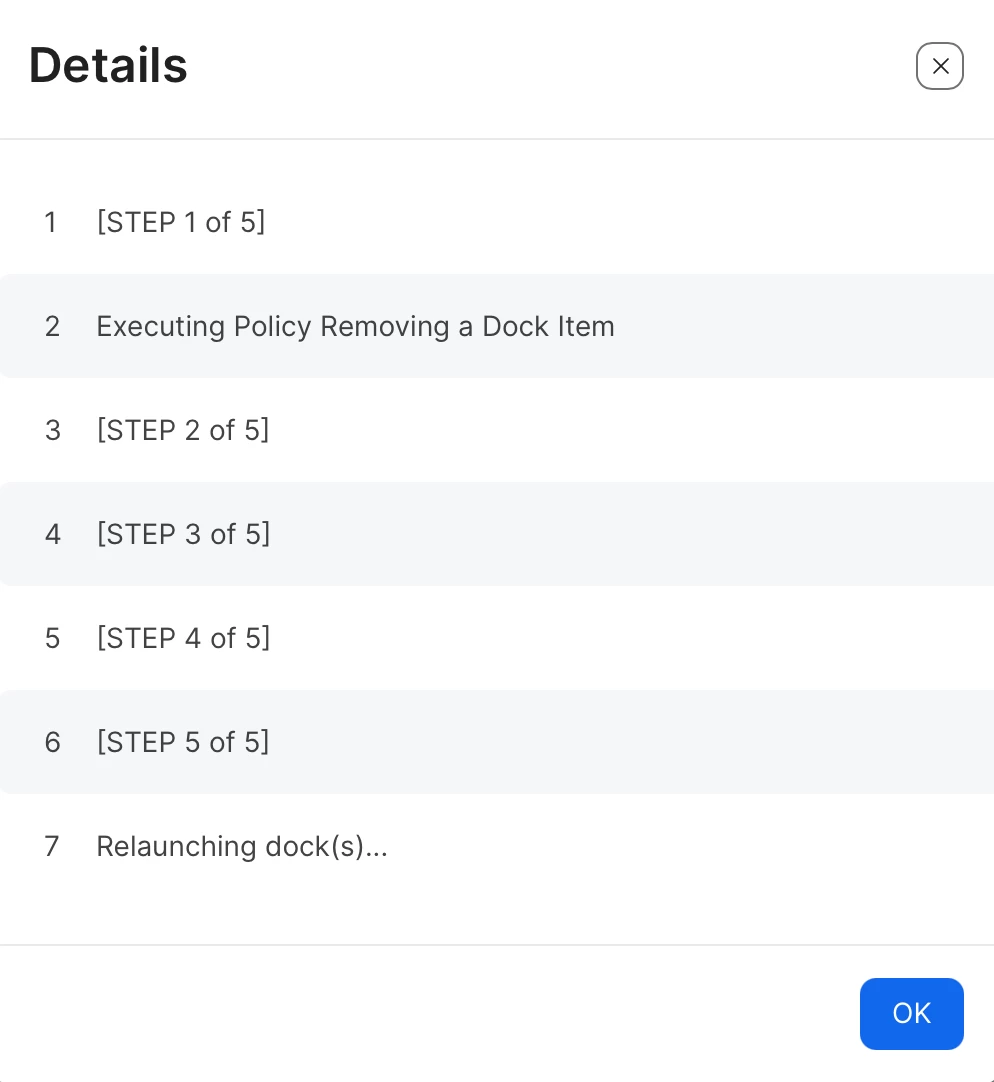

I am facing a weird issue. I just added the policy in Jamf to remove two dock items(mail and Safari). I tried with multiple triggers but it seems when a new user is trying to logged in via prestage enrollment, it is not working.
I have Jamf Setup Manager installed, tried to use that with a custom event trigger for the policy. The policy runs, user logs in, dock reloads but still the items are there. This is the log screenshot:
Point to be noted, when I am running the policy from self service, it's working fine. Any idea what I am doing wrong or how to fix that? Any suggestion is much appreciated.

@rabiul If you're running Jamf Setup Manager in your PreStage you can't trigger a policy for configure the Dock from it because no user account has been created yet when it's running. Running it _after_ the user logs in should work.

Right, but if Jamf Setup Manager is running as part of your PreStage and triggering your Dock configuration policy via a custom trigger that's before an account has been created. You need to take steps to ensure it's not called until after the user has logged in (e.g. use a LaunchDaemon which runs a script that waits for the Finder process to be running then triggers your Dock configuration policy)
