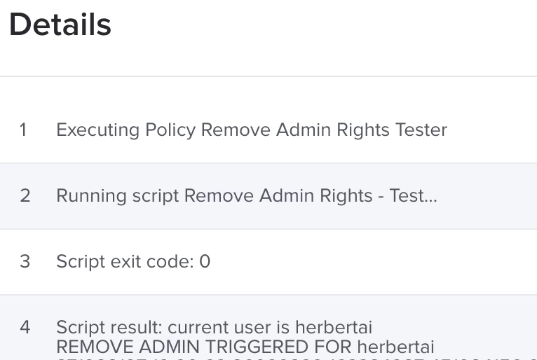

@strayer Hey Mate, I used your script to run a test to make sure it would work. For some reason randomly users are reported as admin, there seems to be no consistency to it. I even remoted to one of the devices and found that the users account was not an admin and when running "id -G username" locally the group 80 was not reported. Why is the script not working as intended? Is it possibly because the is an "80" in the string? If so how can I amend this?
## this will demote the current user if it is not YOURLOCALADMINUSERNAMEHERE
currentUser=$(ls -l /dev/console | awk '{ print $3 }')
echo "current user is $currentUser"
if [[ $currentUser != "administrator" ]] && [[ $currentUser != "*******" ]] && [[ $currentUser != "****" ]] && [[ $currentUser != "*****" ]] && [[ $currentUser != "****" ]] ; then
IsUserAdmin=$(id -G $currentUser| grep 80)
    if [ -n "$IsUserAdmin" ]; then
#      /usr/sbin/dseditgroup -o edit -n /Local/Default -d $currentUser -t "user" "admin"
        echo "REMOVE ADMIN TRIGGERED FOR $currentUser"
                echo $(id -G $currentUser)
    else
        echo "$currentUser is not a local admin"
@djrory Change the grep pattern to '80' to prevent substring matching.
