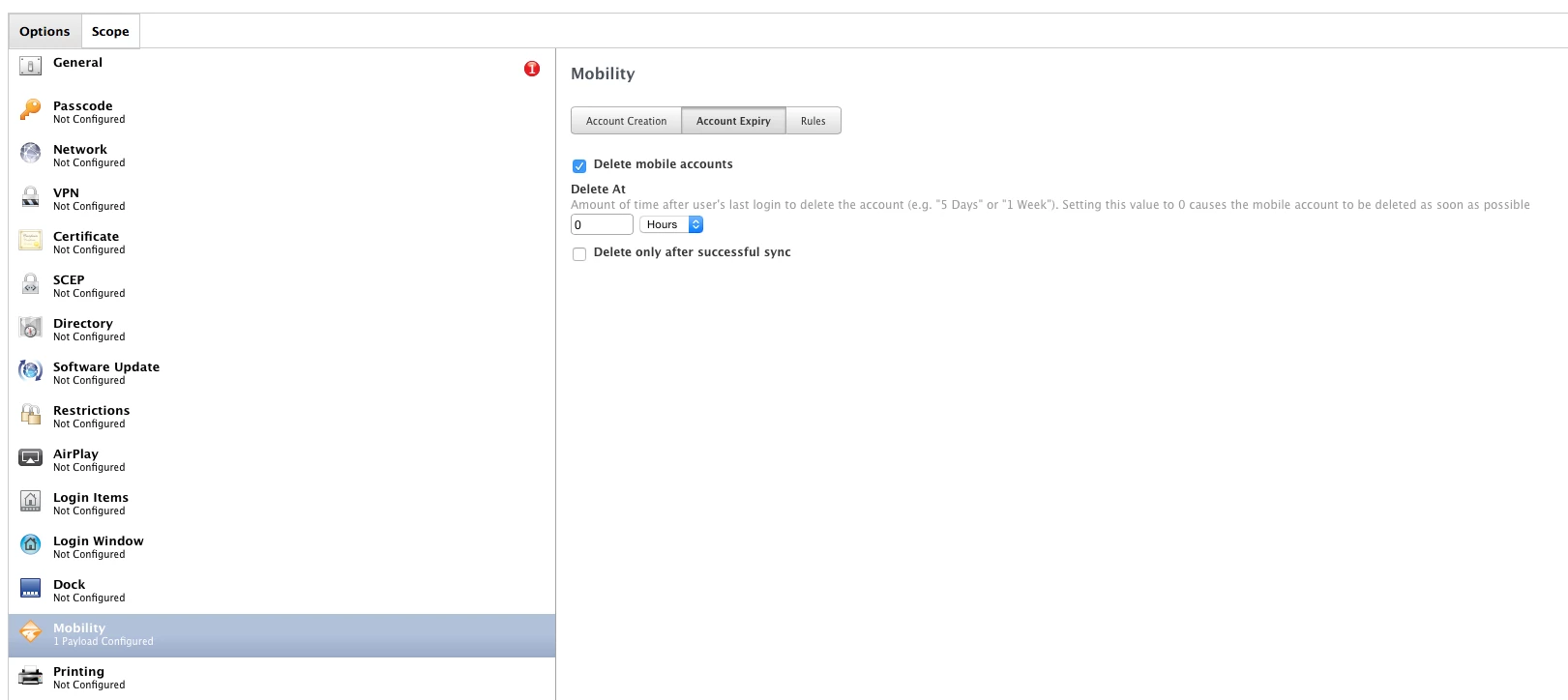

You can also do this from a Configuration Profile, setting the time after that mobile account logs out that it will delete the home folder. We use Casper for our profiles, but I'm assuming there is an equivalent using Profile Manager:
This functionality appears to not be working, at least setting it to 0 which is supposed to delete the account at logout. Neither the mobile account nor home folder are deleted as they should be. In the old days of the OS, say 10.6 with WGM/MCX, this worked properly, but so far it seems to be broken in 10.10.4 using a profile. I have not tried to lengthen the expiration time yet to see if it's only 0 value that is bugged.
I have done this with scripts and logout hooks for 10.8 and 10.9, but it's not a very elegant solution. If Apple's own stuff is broken though, I won't have much choice. I was hoping this profile stuff had matured. And yes hodgesji, all those options in Casper are just pulled right from Profile Manager, it's identical.
