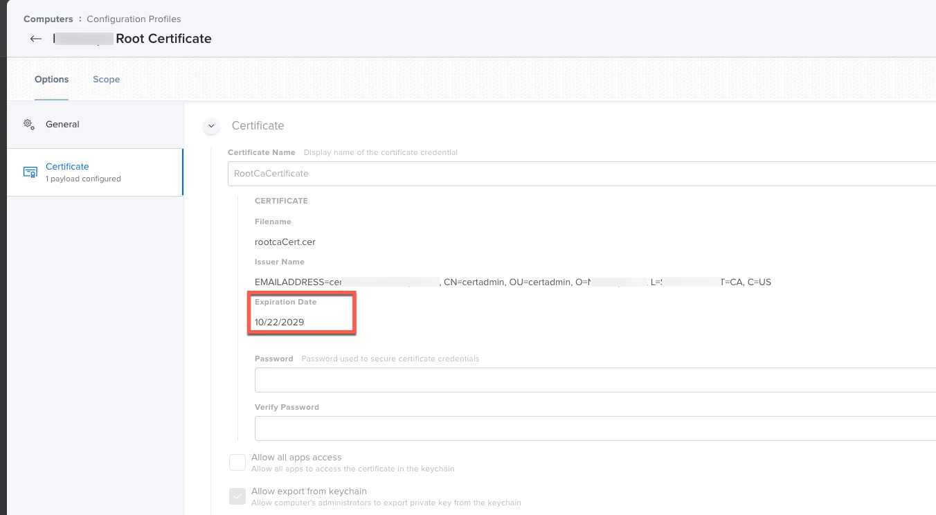

As far as the “Certificate” payload, that is a bit different. You would upload a .cer to JAMF to populate that payload. When JAMF deploys the configuration profile, it literally “copy pastes” the certificate it was given without changing any information including the expiration date. When its time to update a certificate deployed this way. Whoever manages that certificate needs to do the CSR stuff to get a new certificate and give it to you to upload in to JAMF. Once to upload the new certificate in to JAMF, you should see the option to redeploy the configuration profile which will update it on all Macs.
This is an example of a certificate we are deploying. If I need to update the expiration date which is off in 2029, I would need a new copy of the certificate to upload to JAMF. I don’t have access to get this certificate, it comes off of one of our app servers so that app support team would need to give me a new copy. I would edit this configuration profile, remove this certificate and upload the new one. Then tell JAMF to broadcast it. Doing this in a rollout is best, but that is for another time.
