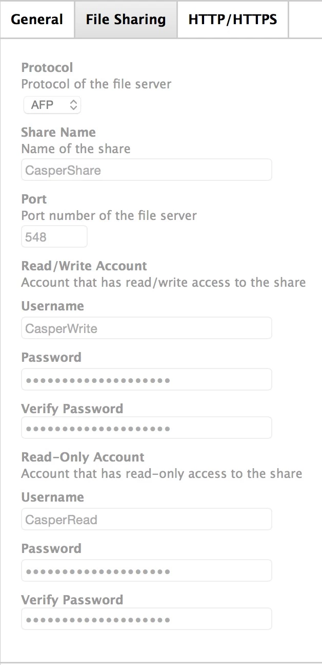

I am attaching an image of the File Sharing settings from my JSS.

I would look at the ACLs on the Mac mini, specifically the inheritance options.
If the inheritance is ok, I'd suspect some kind of file locking from the files coming from the windows server that's preventing a permission change once the files are copied. Possibly test with a dummy share on the windows server with a very light permission structure and see if the inheritance works ok.
