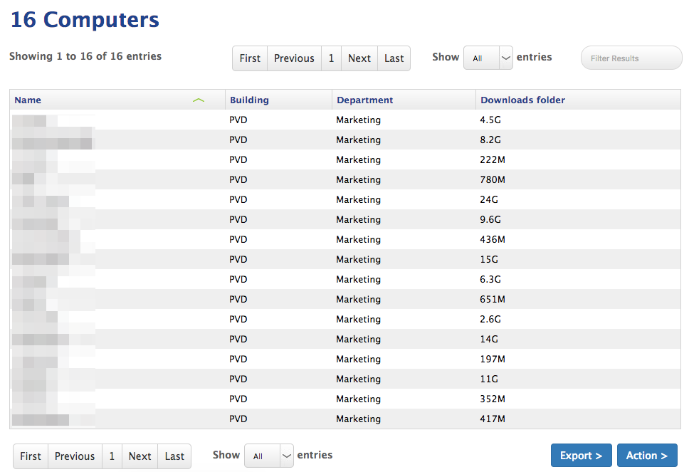

I think you can do all of this within the JSS with an extension attribute. This will be a great way for you to get comfortable with EAs and also custom inventory reports. Extension attributes are really fun (Did I just say that?) because you can turn any script output into an value in that computer's inventory.
More info on Extension Attributes in the Casper Suite Administrator's Guide.
First here's the extension attribute, notice for simplicity sake we assume there's only one user on each computer and that they're always logged in. (We have laptops so this is the case for us) You can build upon this to iterate though all users folders if there are more than one, and/or not have to rely on someone being logged on.
# Modified from CheckDownloadsFolder.sh
# Check and report via EA size of user's home folder
# github.com/acodega
#find logged in user
loggedinuser=`python -c 'from SystemConfiguration import SCDynamicStoreCopyConsoleUser; import sys; username = (SCDynamicStoreCopyConsoleUser(None, None, None) or [None])[0]; username = [username,""][username in [u"loginwindow", None, u""]]; sys.stdout.write(username + "
#find how large User's folder is is
homefolder=`du -hd 1 /Users/$loggedinuser/ | awk 'END{print $1}'`
#echo it for EA
echo "<result>$homefolder</result>"
Once we have the extension attribute configured on the JSS we can then goto Computers, and under Advanced Computer Search click the plus icon. From there, we'll design a search that has criteria matching the computer group or department we care about. Then under Display, check off the computer name from the Computer tab and the relevant extension attribute under the Extension Attributes tab, along with any other info that would be helpful to have in the report then click Search. You can export the search as a CSV or TXT file too.
Here's an example of what it would look like. (My EA reports their Downloads folder)
