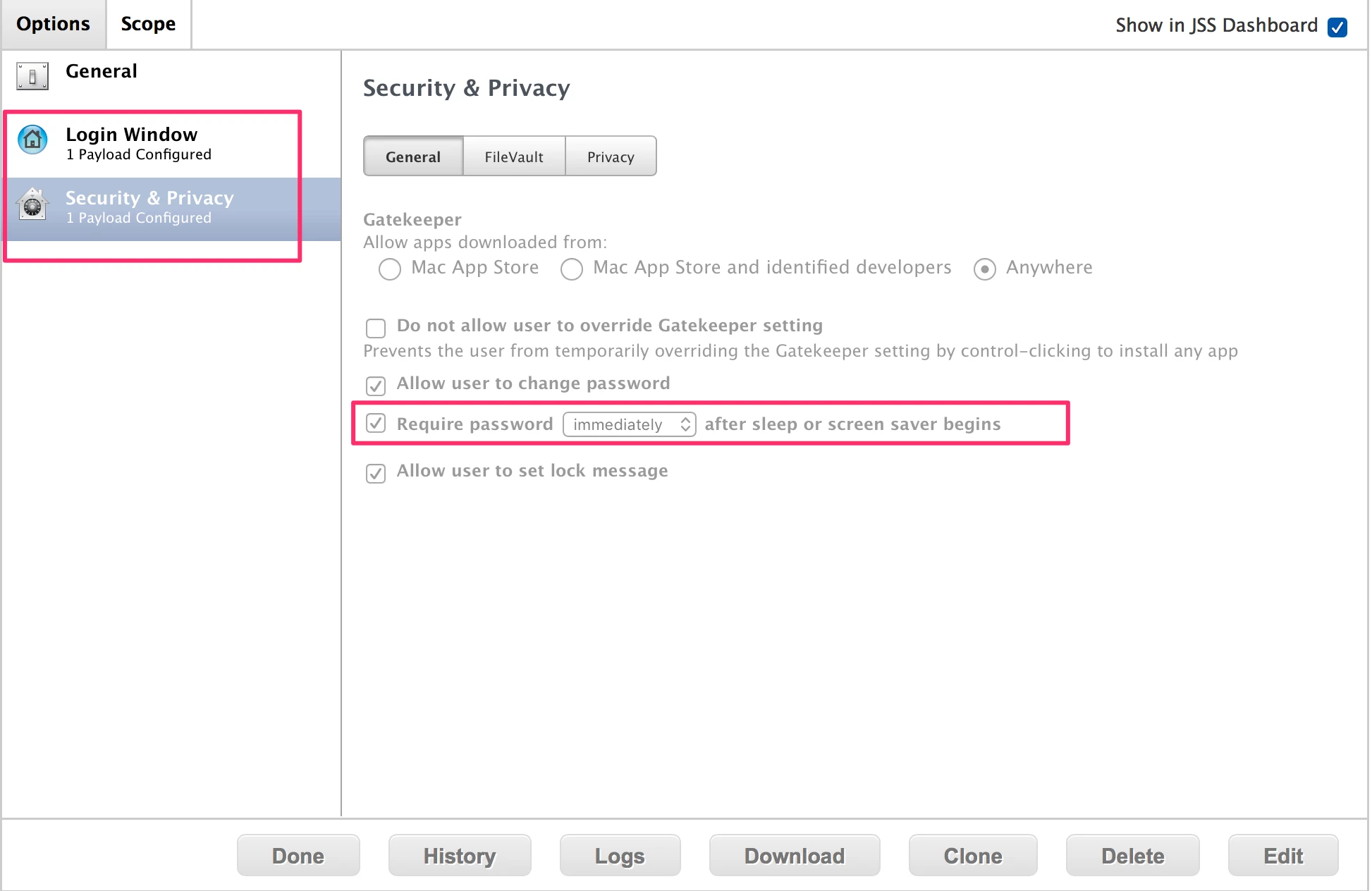

So it looks like the fix is to roll both Login Window and Security into the same Configuration Profile.

Here's what ultimately seems to have fixed it for us:
- Revoke any configuration profiles that contain both Security and Login payloads separately.
- Push out a single replacement configuration profile that contains both a Security and Login payload, with the Security payload configured to activate screen lock after 0 seconds (other values may work, this is what we use and what was tested).
- Issue a command for each user:  defaults write /Users/<username>/Library/Preferences/com.apple.screensaver.plist askForPasswordDelay -int 0.  Make sure to chown the plist to make the logged in user owner (chown <username> <path to screensaver.plist>).
- At this point the screen lock will either work right away, or the system will require a reboot.
It also doesn't matter if you reverse steps 2 and 3, just as long as you don't have any profiles with a singular login and security payload installed.  Step 3 was also crucial, and trying to instead push out the plist as a custom setting config profile did not work for us.
We pushed this out to everyone on Wednesday, and so far have had no other issues.

            I'll just throw my 2 cents in.  I was having this same issue and combining my "Login Window" settings and "Security & Privacy" settings into one profile worked for me too.

What did was I also combined both config profiles together (login window & Security and privacy) - Set the require password to immediately AND also added Custom Settings (screensaver plist) found here http://www.johnkitzmiller.com/blog/security-privacy-configuration-profile-bug-in-casper-9-82/
So far so good. I re-imaged a test machine on 10.11.3 and the screen lock took effect immediatly after sleep or screen saver. My login window stayed the same. Im still able to see our banner.

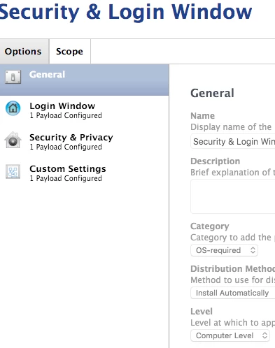

Originally we had a configuration profile setup for each payload, on the advice of our jump start tech.  So we had one profile that contained a Security payload, and another that contained a Login.  I revoked both of these first, and then issued a new profile with the combined payloads (as mentioned by several others).  The profile looks like this:
This alone was enough for some clients, and seems to have been all that was necessary for most in this thread.  But in our environment we also had run a script in a separate policy, once per computer.  Additionally, after both updating the profiles and running the script some clients had to reboot before the settings took effect.

            Instead of running a separate script -- add a Custom Setting (screensaver plist) into the config profile.
Our config profile contains the following payloads:
Login Window
Security & Privacy:-  Require password immediately after sleep or screen saver begins
Custom Payload: com.apple.screensaver
<plist version="1.0">
<dict>
    <key>askForPassword</key>
    <integer>1</integer>
    <key>askForPasswordDelay</key>
    <real>0.0</real>
    <key>tokenRemovalAction</key>
    <integer>0</integer>
</dict>
</plist>
This works perfectly for current and newly imaged machines. It applies instantly to both 10.10 and 10.11 machines. We are on 9.82

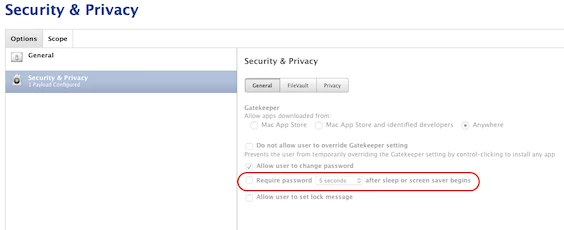

            After all of these issues related to lock screens, screen saver times, sleep times etc, I have decided to simply diable the setting altogether. Not worth the trouble at my company because we dont have a top-down mandatpry policy for lock screens (we are not  bound by SOX or HIPPA etc).
I have unchecked the setting "Require password X   after sleep or screen saver begins" in the Security & Privacy Payload, and I have unchecked the setting "Start screen saver after X" in the Login Window Payload, but my  end users are still complaining that they still cant disable/change these settings.
Screenshot below clearly shows the setting is no longer enabled on the JSS, but the clients are still prompted for passwords at 5 seconds. Apparently this is making users grumpy.
 I just want to punt on this particular Profile. Not worth the energy and time to babysit it.
