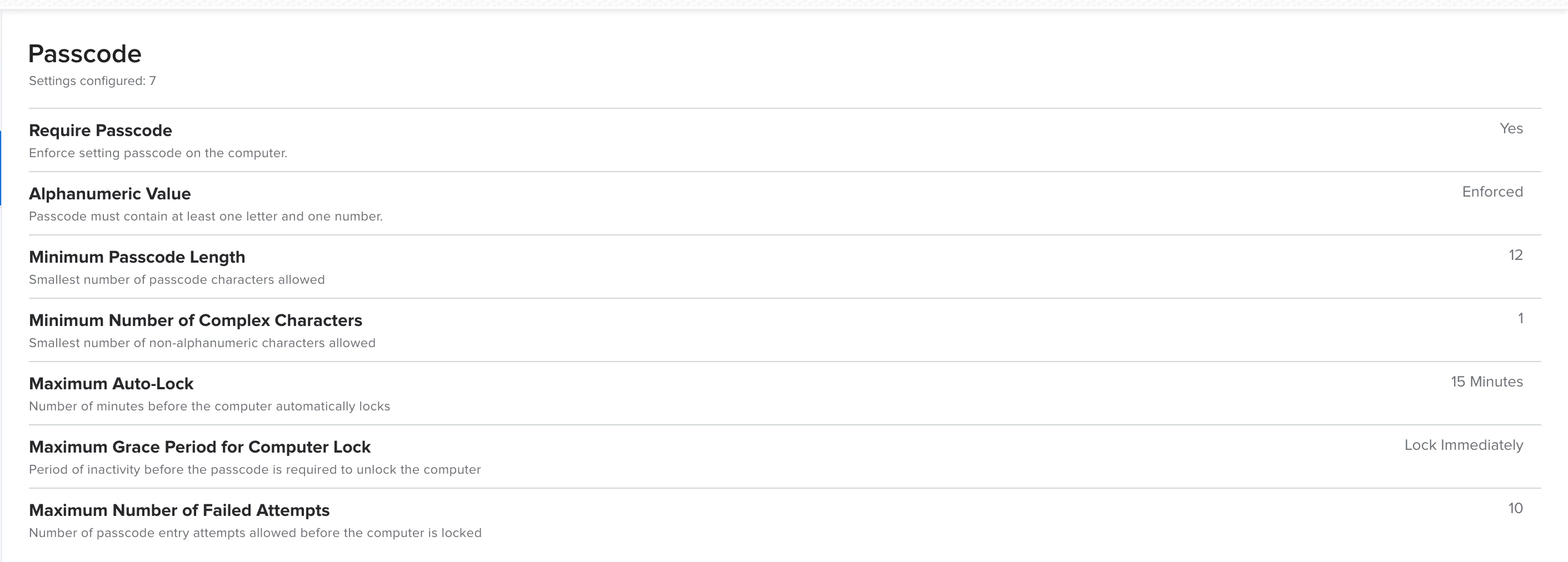

Hello Jamf Nation,
We are working on a project to require all of our users to update their passwords lengths from 8 digits to 12 digits.
I already have a configuration profile setup for the minimum passcode length (see below).
Additionally, I have a script setup in a policy to grab the user ID and set the device to require a change of password (see below)
# Pulls the current logged in user currUser=$(ls -l /dev/console | awk '{print $3}') pwpolicy -u "$currUser" -setpolicy "newPasswordRequired=1"
My question is, is there a way to add to my script to check the length of the current user password and if it meets the password requirements, to skip and not require a password change?

Hello AJPinto,
Thanks for the reply. I setup a configuration profile to test on a machine.
The machine had an 8 digit passcode, and the configuration profile called for a 12 digit passcode.
- It did not require the machine to update the password when applied. The only way it would, is if you have "Change at Next Authentication (macOS 10.13 or later)" toggled on to "Enforce".
Without having the option above toggled on, the machine was never prompted to update the password 😥
