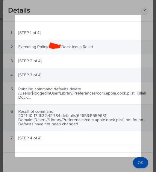

@mm2270  hi, the command to reset the logged in users dock does not work. Here are screenshots of the policy and the log entry for the computer that the policy ran from (self service policy). Users dock remains the same.
Try changing your variable to say $3 for instance. Unless I'm missing something but I believe $loggedinuser would require you run this in a script to capture that logged in user variable.
