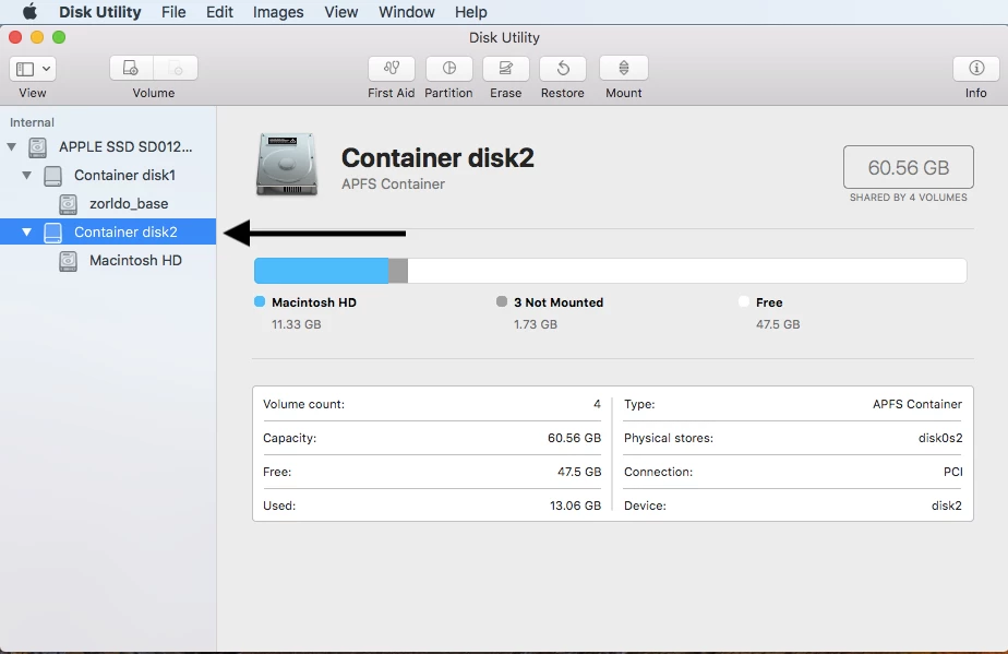

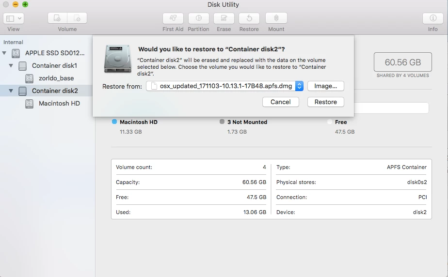

You have to restore the APFS image to the APFS container, not the volume.
Bear in mind the client will need a firmware update supplied by the High Sierra installer to understand how to boot from APFS. After the firmware is up to date you can restore an APFS image to an APFS container and have it bootable.
