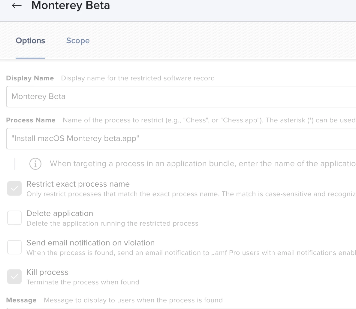

I am trying to restrict Monterey Installations for the time being using Software Restriction in Jamf.
I have 2 restrictions.  1 for Beta and 1 for release.
When the installer runs I see the process name in Activity Monitor
Install macOS Monterey beta.app
I have this listed in the Restrict Software under Process Name.
But when I run the installer the process does not kill on the machine that is being restricted.
Is something not correct in my Restrict Software setup?
Thank you.
You have restrict exact process name checked. You'd need to run the installer and grab the process name from Activity Monitor to use that. If it's unchecked it will use the file name which could be renamed if you have intrepid users who want some Monterey action.
@Fardoomz You can block the GUI for all macOS installers by blocking the process named "InstallAssistant" and specifying "Restrict exact process name". This does not block the `startosinstall` tool however so depending on how persistent your users are you may want to block that process as well.
When I've setup my restrictions, I don't believe I have ever used quotes in the field. Not sure if that may affect it. Also I had to create an Install macOS 12 Beta.app when they first released, but think that was corrected and they all comedown as Install macOS 12 Beta.app.

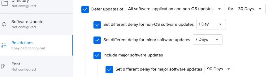

@Ken_Bailey are you using JAMF Cloud ?   We are still JAMF on prem, running JAMF 10.27, and not seeing the same options within Defer updates as you have above.    Putting it down to a later release of JAMF which incorporates that granular level of control.  More reason for us to upgrade to latest JAMF release I guess, and all the work that involves  😞
We just migrated to the cloud last week. We were on prem when I posted this and running the latest version of Jamf Pro at the time.
Based on the release notes for Jamf 10.32 the deferral options are only compatible with macOS 11.3+ (unless I'm reading that wrong).

@Ken_Bailey I'm struggling to figure out how to set the above so that Monterey is deferred for 90 days but allow things like the Big Sur 11.6.1 update released today.
Would Big Sur 11.6.1 be considered a "minor software update" ?
I'm waiting for the 11.6.1 Big Sur Update to start showing as available here so I can play around with the settings to try and figure it out.
We want to ensure people are still getting any Big Sur updates that Apple releases, but not Monterey.
@johnsz_tu we ended up pushing the configuration profile with just Defer updates of Only major software updates for 90 Days. We have a number of users who have upgraded to 11.6.1. None have been able to update to Monterey yet. So the Big Sur updates should be minor software updates, based on what I am seeing in our environment. The major update should only be a new OS like Big Sur to Monterey.

What version of JAMF pro are you running? We are on 10.30.3 and don’t have the same deferral options.
We migrated to the cloud recently. Currently on 10.32.2
