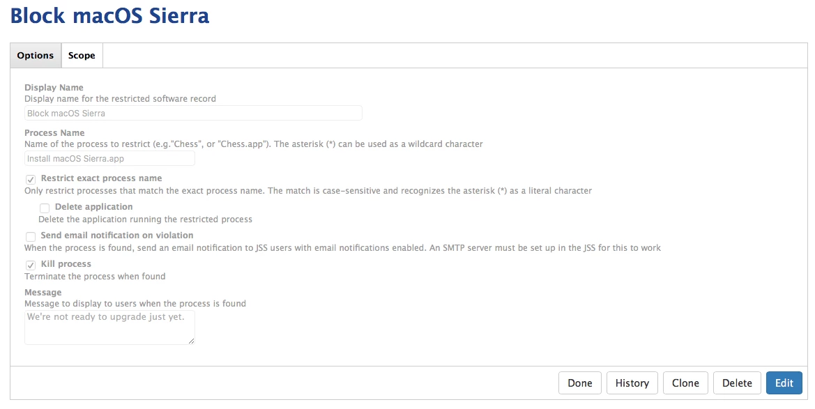

I already have beta releases deselected, I also have software update pointing to my OS X Server software update server which is blocking all updates so I have two go with the restricted software method to make sure people don't install it. The string I'm currently using to block processes is
Install macOS Sierra.app
And for the beta I'm using
Install macOS Sierra Public Beta.app
which works perfectly. And I understand using osinstallersetupd will block Sierra even if they rename it, but I'm not too worried about end users renaming the installer here.

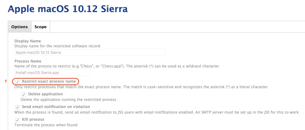

Do you also select the JSS option to "Restrict exact process name"?

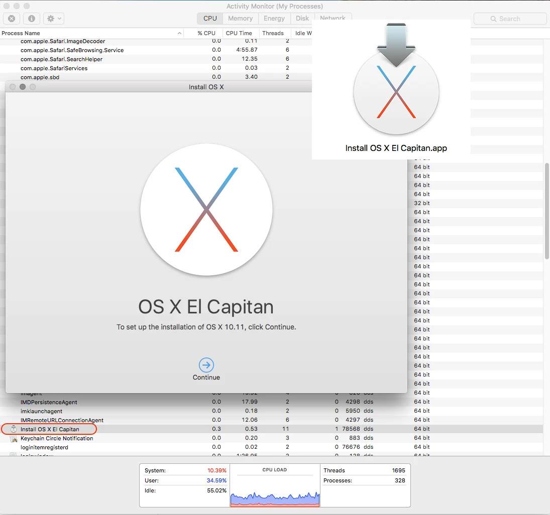

I ask because while the installer app will likely named "Install macOS Sierra.app", the process itself is likely to be "Install macOS Sierra".
Here are my proposed JSS restriction settings:
@dstranathan Yeah, for example in my beta restriction, I am using Install macOS Sierra Public Beta.app, using the exact process name, and it works. In fact when I tried to install the beta on my test Mac, I had forgotten to include myself in the exceptions list, and when I tried to install the beta, Casper blocked it.
Somebody correct me if I'm wrong, but I seem to remember this issue from previous OS releases too, we had to include the .app in the exact process name for it to work.
Confirmed: "Install macOS Sierra.app". No surprises here.

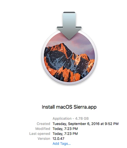

I pulled down the GM candidate yesterday, and noted the name as
Software restrictions don't seem to be working for this in JSS 9.96. Opened a ticket with JAMF for clarity.
Same. I can't get restrictions work. Checking activity monitor shows "Install macOS Sierra" as the process.

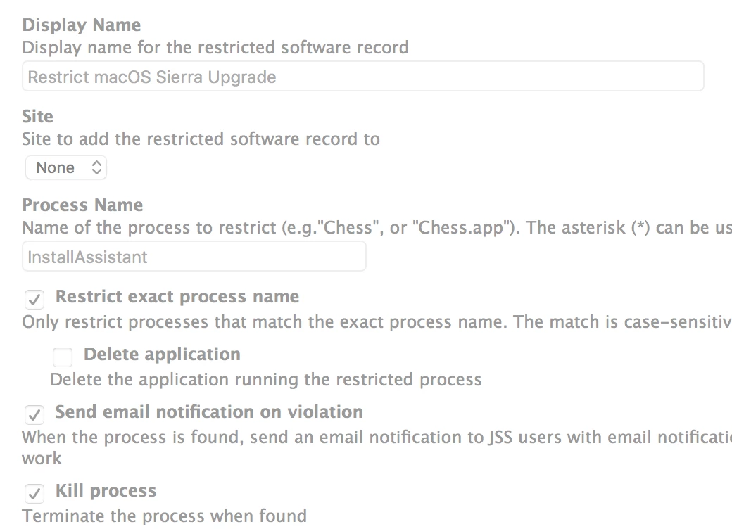

though of share... using "InstallAssistant" works for us..
