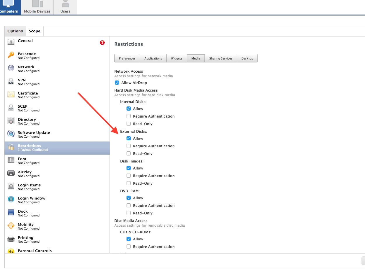

  • April 26, 2016
Thanks @Person & @Bhughes. I looked at the restrictions configuration profile before and that was able to block bluetooth as one of our other requirements but from what I understand the media section only blocks certain peripherals and not all USB devices?
Thanks @htse I'll give those two kext files a shot.

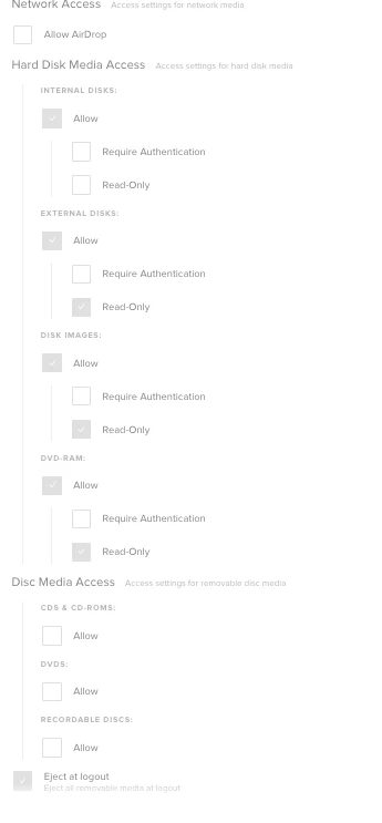

  • June 16, 2016
So i couldn't get the above screen shot to work. Could anyone? USB still has write to it.
  • June 16, 2016
@jalcorn The config profile always worked for me in 10.10 and 10.11 but didn't take effect until after a reboot. We blocked USB storage altogether, didn't try just restricting writes. I assume you are choosing "Read-Only".

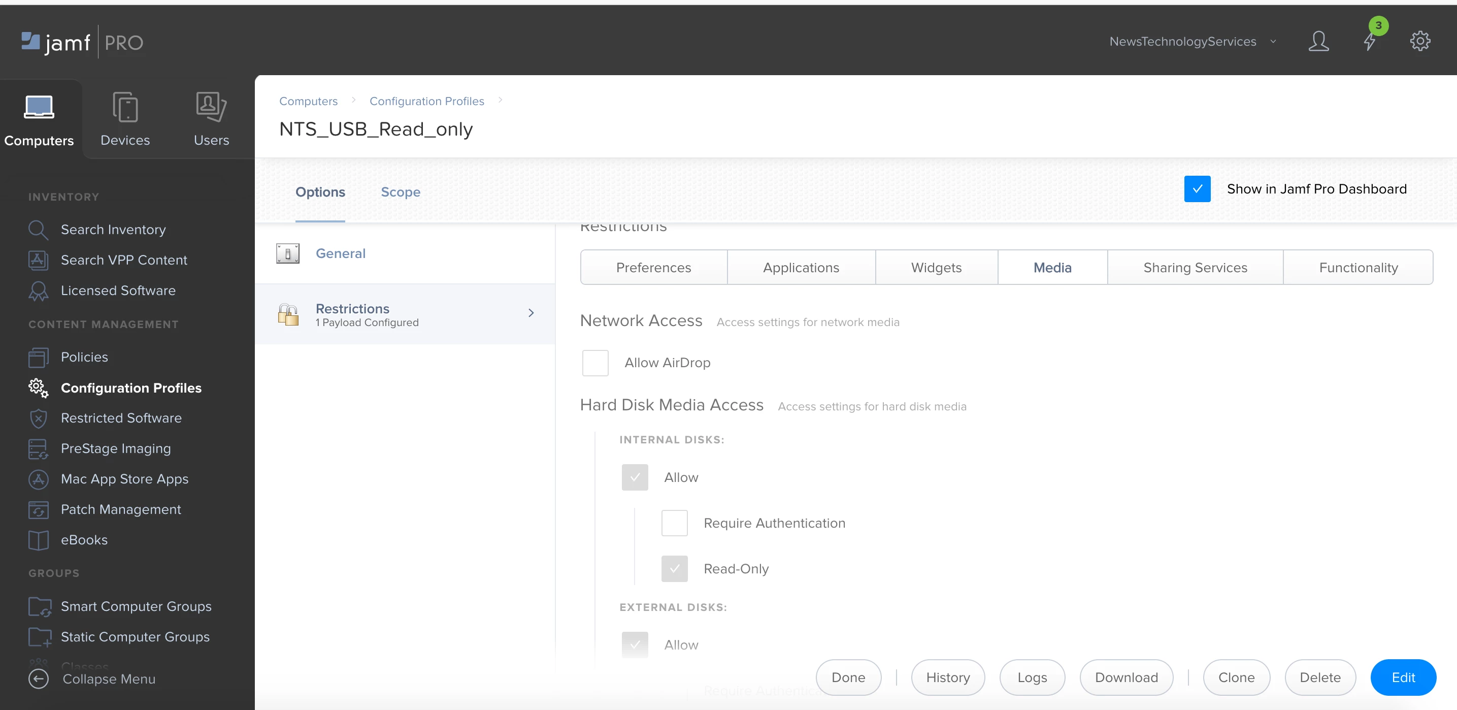

  • August 28, 2019
I have tried with JAMF by doing the USB -Read-only but once worked me and after reboot the machine still working there is no use is it working

@janderson1 I hope if the profile1 is enabled the USB access & Profile 2 is disabled the USB access but the issue there are number of profiles with the above configuration to be witch one will be considered ?
so the issue is occurring because of Conflict number of profile as like given below so need to be mergied the profiles.
mani2care
  • December 2, 2020
i found the solution for the USB block -> Restriction compliance should be a one -> MDM profile allow once impact the machines -> if has more configuration profile it conflicting.
1) profile 1 -> Allowed the USB 2) Profile 2 ->Blocked USB it means which will accept the MAC so here conflicting the restriction validate the older restriction tab and make it one and push to end user machines workd perfect.
