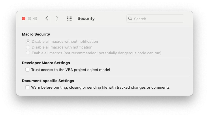

My task was to to have every user (not computer) have the Macro Security locked to "Disable all macros without notification"
There was also to be an exclusion group for users who would not be controlled by the above lock.  For the exclusion group, we wanted if possible for them to be locked instead to "Disable all macros with notification" as that setting allows a user to enable macros on a document by document use

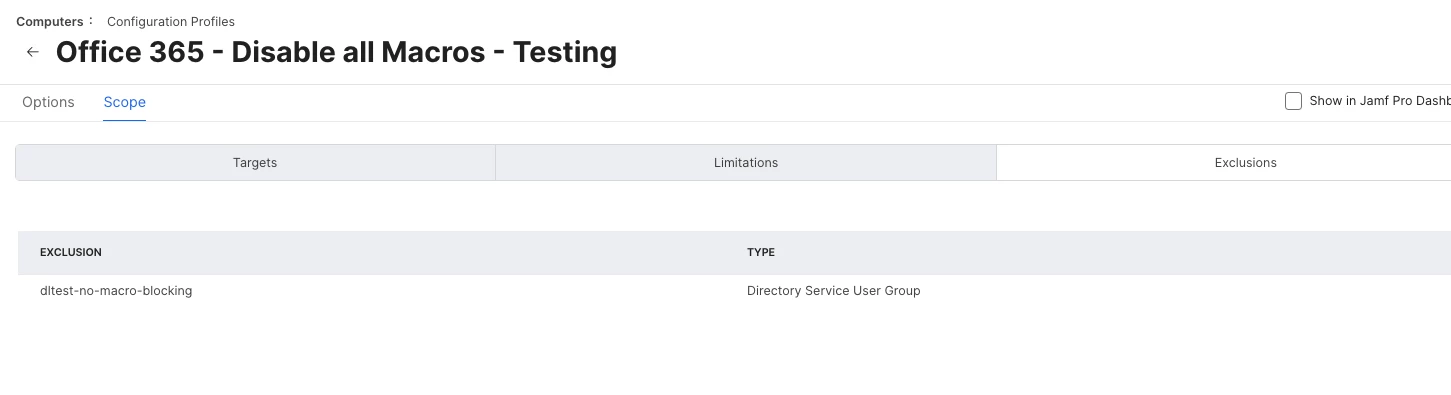

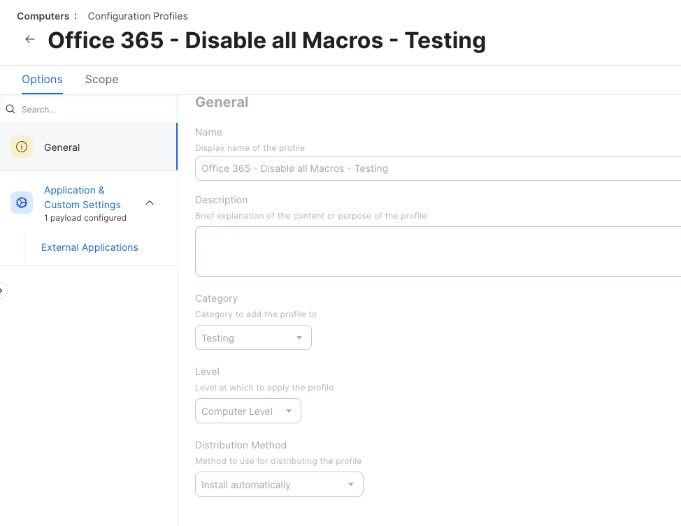

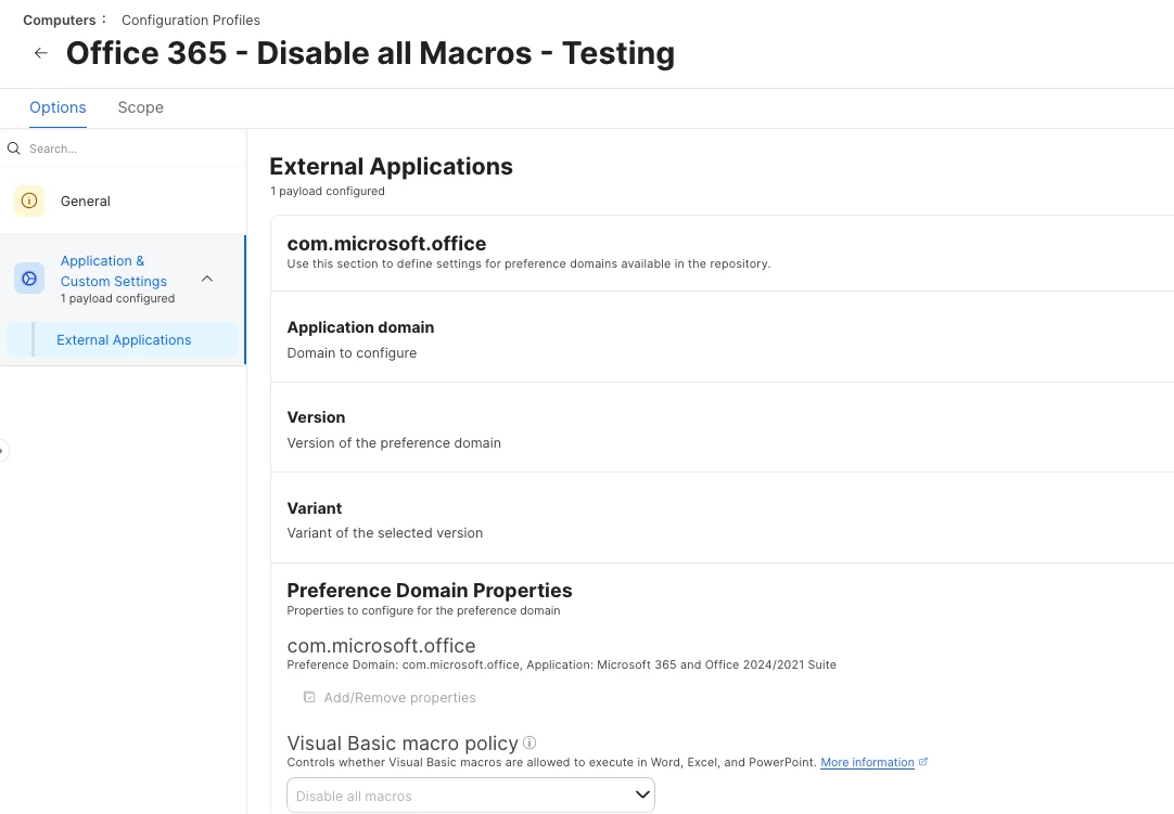

I found that the settings for this in the Configuration Profile only work on a "Computer Level" even though they seem to be User settings
My Configuration Profile looks like this:

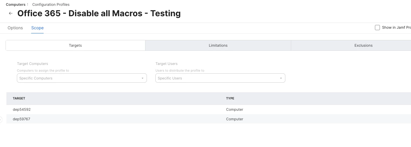

This works but generally takes a few minutes for the machine to pick up a change in the group from AD
If I try and make a second Config Profile and scope it to that AD group to have the setting locked to "Disable all macros with notification" it doesn't take.  I'm thinking because there are two Config Profiles that are scoped to the same key, that neither is used.
Is there a way to do this that anyone can think of?  That is, for a select AD group of users we get it locked to "Disable all macros with Notification" and for everyone else we get it locked to "Disable all macros without notification"?

For the scoping part, yes Jamf supports scoping to AD group but you must keep in mind Jamfs scoping in checkin based. So there will always be a delay when scoping to something like an AD group and the configuration profile deploying.
Your hunch on the two configuration profiles targeting the same domain causing problems is correct. If you have two configuration profiles targeting the same domain (ie com.microsoft.office) and targeting the same key, macOS will error the profile out, garbage in garbage out. You will need to build an exemption in to the main profile, so it is removed if the second profile ever targets the device.
Final parting thought, macOS does support user level configuration profiles but the user must be MDM enabled. All mobile account users (accounts from AD) are MDM enabled by default. However, how configuration profiles behave with user level interaction is up to the developer and again most Apple device management is machine level.
