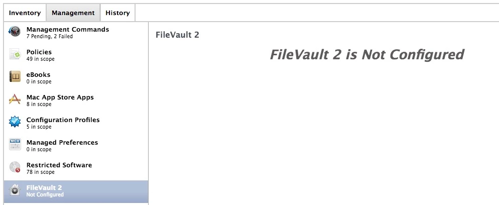

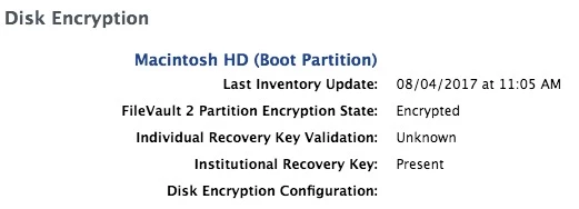

After our last JSS update (9.101) and upgrade to High Sierra, I started noticing that IRKs were disappearing from the JSS. Disk Encryption says IRK Validation is Unknown. FileVault2 section in Management tab shows "FileVault 2 is Not Configured". I've been using this script from homebysix: [https://github.com/homebysix/jss-filevault-reissue](link URL) and it works great.

Hey @jriv is the Escrow IRK Profile installed to the machine? This would be done with a Config Profile > Security & Privacy > FileVault. If the IRK was in the database it would be most likely hashed.
