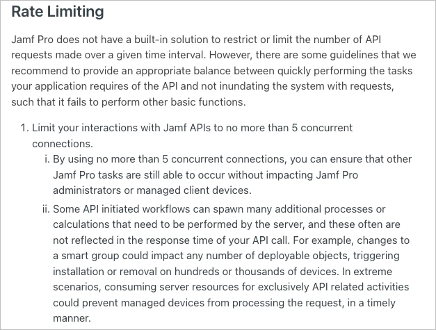

unless Im reading the documentation wrong (very possible) you don't want to run API calls from the end point (people do, not sure they should) as how would you rate limit this?
Maybe something like Postman would help?
