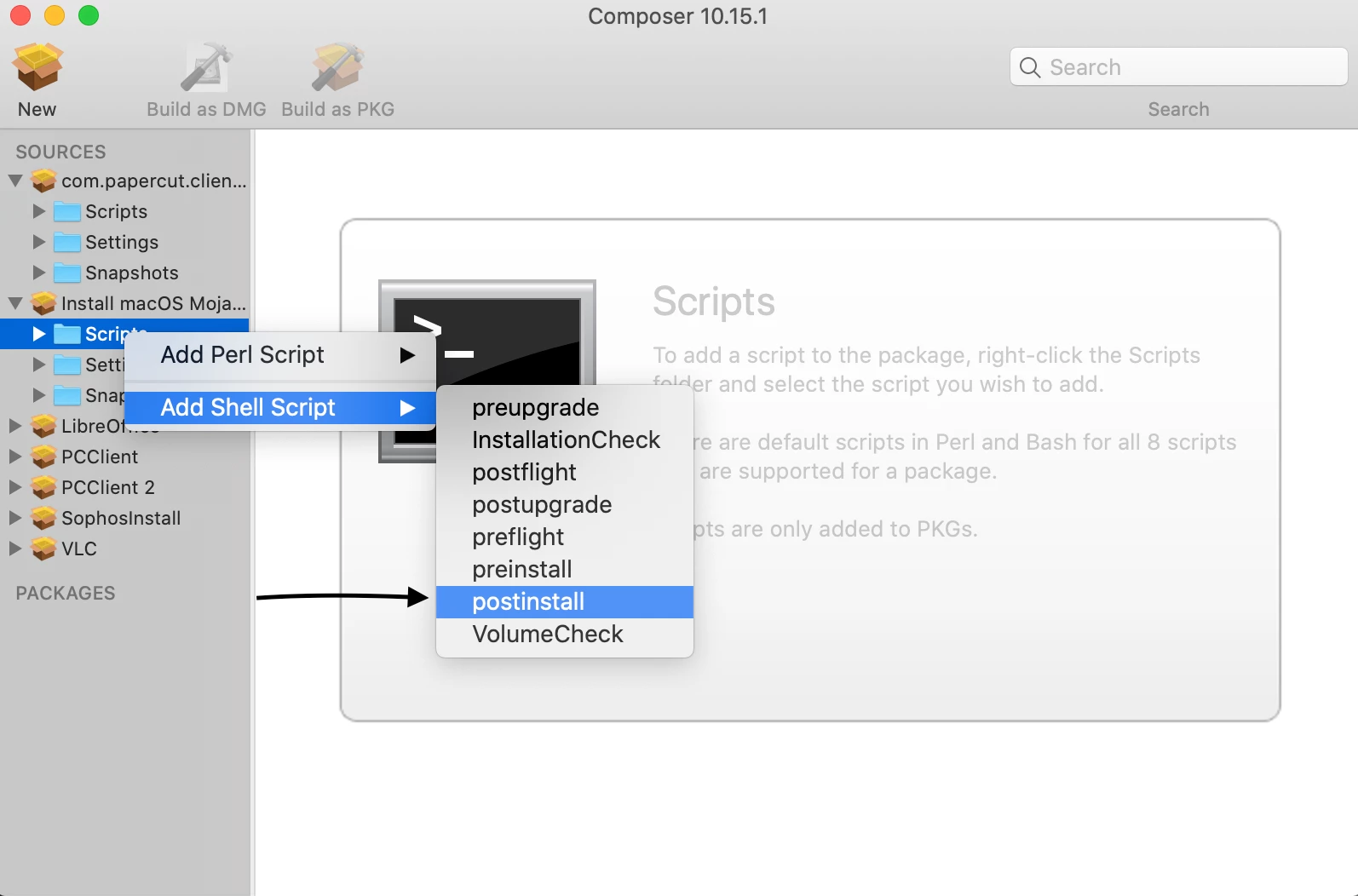

You can do this within Composer before you create the .pkg file, I will attach image below.

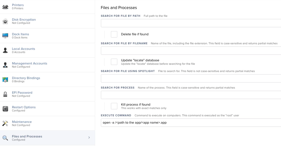

Another way is use "Files and Processes" of a policy to call the app.
That saves you from re-downloading it and give you flexibility on re-using the app.

@hansjoerg.watzl 'Files and Processes' is the last thing to run in a policy.

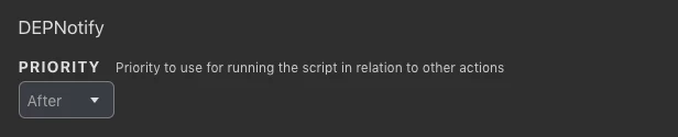

You could also add scripts before or after packages (as mentioned by drtaru) to create the policy flow.

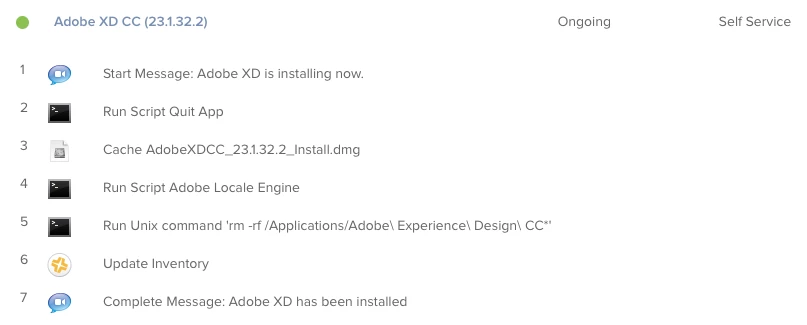

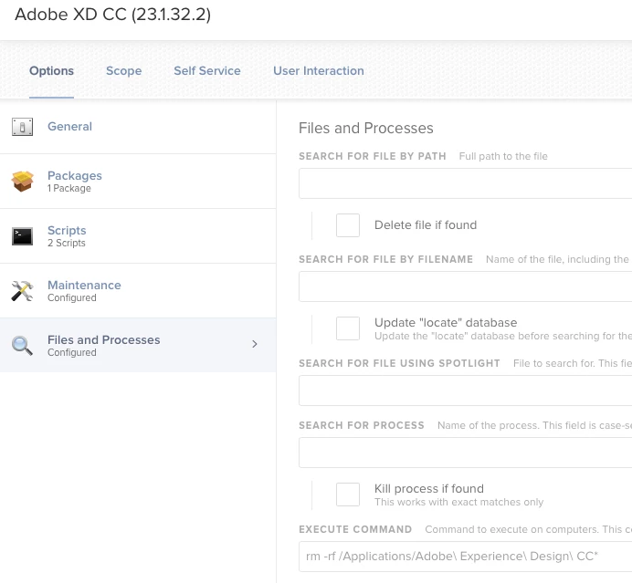

Here an example of an Adobe policy we use for the self-service.
I hope this helps!
Thanks, yes I tried it with "Files and Processes" and can confirm, that it was executed as last.
I knew I could also use a script (with After setting), but as it's only a short command, I don't want to create a script just for this simple command.
