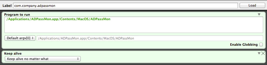

Here is what I use for my launchagent which we put in /Library/LaunchAgents/ It makes sure that ADPassMon cannot be quit which sounds like what you're trying to achieve.
  <plist version="1.0">
  <dict>
      <key>Label</key>
      <string>com.company.adpassmon</string>
      <key>ProgramArguments</key>
      <array>
          <string>/Applications/Utilities/ADPassMon.app/Contents/MacOS/ADPassMon</string>
      </array>
      <key>KeepAlive</key>
      <true/>
  </dict>
  </plist>
Not sure if it helps.

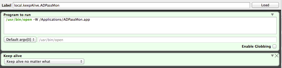

The LaunchAgent that i was using to keep the app alive was created by Launch Control, comparing @bpavlov's LaunchAgent i noticed the Launch Control created one uses /usr/sbin/open and the other uses the path to the binary.
The load command has been working 100% so far with the latter LaunchAgent, the one question i have is are there any implications with launching the application directly from the binary rather than the Application itself?
Thanks for all your input!

using this LaunchAgent (preferred this method as it played nicer with launchctl load and also launching via the binary quits the app when the agent is unloaded)
<dict>
    <true/>
    <key>Label</key>
    <string>local.keepAlive.ADPassMon</string>
    <array>
        <string>/usr/bin/open</string>
        <string>-W</string>
        <string>/Applications/ADPassMon.app</string>
    </array>
</dict>
</plist>
