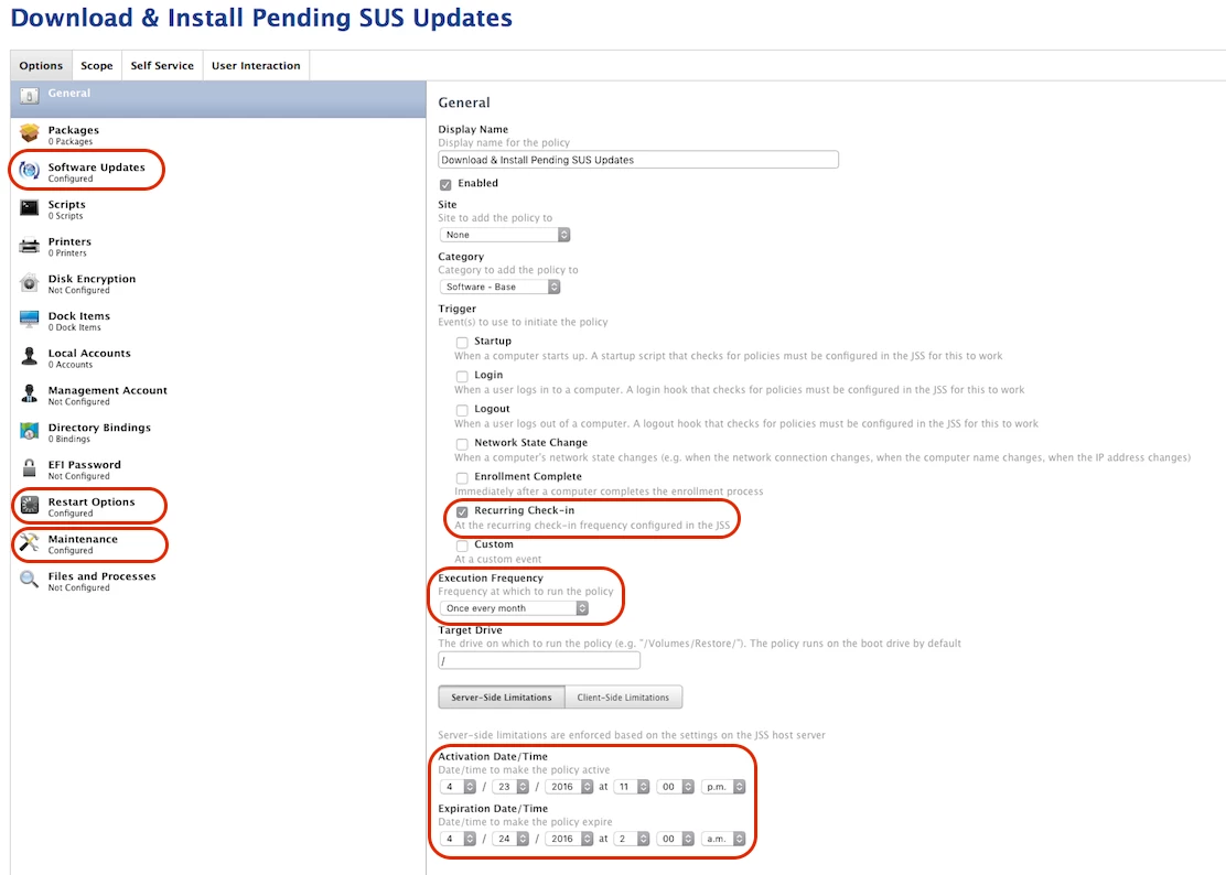

I took my first stab at running a scheduled Policy that downloaded/installed SUS updates and then rebooted clients as needed. See screenshot for reference.
In a nutshell, my IT dept has a monthly maintence window on the 3rd Saturday night of each month. Typicaly, all Win/Mac client updates should be downloaded/installed (and rebooted) between 11 PM and 2 AM. This time window is likely adequate for me, as my Managed Mac clients check in every ~15 minutes and thus most systems should get the Policy applied in that time window.
Trigger: Check-In
Frequency: Once per month
Activation Date/Time Schedule: 11PM April 23 (Sat PM) - 2AM April 24 (Sunday AM)
I wasnt sure how this would go, so I watched it closely to observe the behavior. Still a bit confused on a couple aspects.
1) Regarding the Policy itself:
Does my Policy look like sound logic to you? Please refer to the screenshot.
2) Regarding the results:
I noticed a lot of systems are still flagged as "Pending" according to the JSS log. Does this mean that the Policy will still try and run on Pending Macs, even though the scheduled time has lapsed? (I hope not as that means those Macs could possibly be rebooting during the day). Or does this mean that for whatever reason, those specific Macs never checked-in to get the Policy applied?
Mac users came in to work today (Monday) and were greeted with a prompt to reboot. So until they clicked the GUI OK button, the Macs did not get rebooted. Oops! I dont see anywhere in the Policy or its Payloads that this pormpt should have occured (i.e.; no Deferals were active etc). I was hoping to force the reboot without interaction. Thoughts on what went wrong?

I haven't tried what you are doing, but I do have a thought on your setup. I would set the execution frequency to ongoing. You have the activation date/time set to restrict when this will run. WIth once every month set, if the policy fails the first time it runs, it won't try again in 15 minutes - it will try again in a month. If you set it to ongoing, it should run every 15 minutes during your activation date/time, then stop running. I think that would give you better results.
Keep in mind that this is all off the top of my head - I haven't actually tried it.

Yes indeed, Im very similar to you. I manage my own SUS as well. I do a (very narrow) testing on a groups of IT Macs. I also scope to a Smart Group that has SUS updates pending (i.e.; only Macs that actually have updates waiting are affected).
What Im lost on is how the JSS handles "Pending" updates on scheduled (time-sensitive) Policies (once the schedule has expired, how are Pending Macs treated, etc), and why my Macs got a "reboot?" GUI message.
Mind posting a screenshot of your Policy?

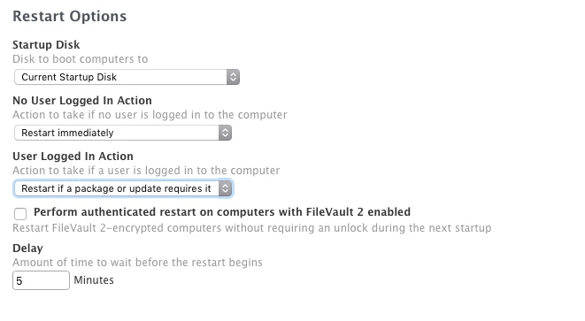

Here is my restart Payload (See screenshot).
The options (if users are logged in) are:
-Do not restart
-Restart
-Restart immediently
-Restart if package or update requires it
What's the difference bewteen "Restart" and "Restart Immediently"???
I have also noticed that Im unable to delete the text string "This computer will restart in X minutes. Please save anything you are working on and log out by choosing Log Out from the bottom of the Apple menu.". The message repopulates as in the JSS as soon as I click "Save".
mm2270
  • April 25, 2016

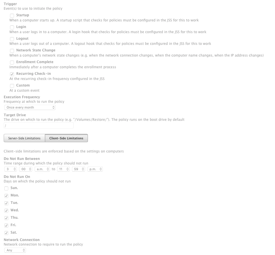

If the policy is only on for a short period of time and then it goes to Disabled, the machines in the Pending state will never run it, at least while its disabled. The frequency, check-in and other values have no say in running the policy if the JSS knows the policy is off/disabled. You can't override the On/Off state of the policy, even if the Macs fall into the Smart group that should run it.
You're better off using the Client Side Limitations tab and setting the policy to only run during a certain timeframe and on a certain day or days, and keep the Execution Frequency to once every month. But don't have it disable after a few hours. When the next month comes around the policy will still be active and if the Macs it missed the previous round happen to be on during those hours, they'll run the policy.
As for the reboot message, the only way to not have some kind of message is to set all those options to do Do not restart. As soon as you choose any of the restart options, you have to have some kind of message in that field. Restart Immediately appears to be a Self Service option. See this thread for more on that: https://jamfnation.jamfsoftware.com/featureRequest.html?id=34

To avoid user intervention/notifications, are you suggesting that I remove the "Restart Options" Payload and just run a simple reboot script (or one-liner command via the "Files & Processes" Payload) after the SUS updates are applied?
Would you suggest /usr/local/bin/jamf reboot -immediately, /sbin/shutdown -r now or /sbin/reboot?
Are you suggesting using a combination of Server-Side Limitations and Client-Side Limitation or running ONLY Client-Side Limitations?
Im still not clear on how the Client-Side Limitations tab works exactly (its not described in the JAMF Admin Guide at all). To me, it sounds like when May 1st (which happens to be a Sunday) comes along, Macs that are in the Smart Group Scope will start to fetch SUS updates (This woud be ~3 weeks before the maintenence window arrives and not acceptable.)

@dstranathan Sorry for the delayed response. So, you need to be careful about doing an immediate reboot in a scripted way in a policy. Reason is, if the reboot occurs before the policy completes and uploads a log to the JSS, the policy status will remain as Pending for those Macs, which means it may run again at next check-in, assuming its still in scope and the policy is active and all that. The JSS uses the policy log to know that it actually ran since it needs confirmation back from the client. As long as it doesn't see a completed log, it will think it needs to be run on those Macs.
I think some folks here do something like:
/sbin/shutdown -r +2 &
which puts a 2 minute reboot delay and pushes the process to the background (the "&") which allows the policy to complete and upload a log.
You could also use the jamf binary for this as you noted. From the jamf binary help page
jamf help reboot
Usage:   jamf reboot [-minutes <minutes>] [-message <message>] [-background] [-immediately]
     -minutes        The minutes until the machine should reboot
     -message        The message to display to any logged in users
     -background         Background this process (don't wait until the reboot to exit)
     -immediately        Reboot now without warning users
You could do something like this:
/usr/local/bin/jamf reboot -minutes 2 -background
That's essentially equivalent to the shutdown -r +2 & command I posted above. Sets a 2 minute delay and pushes the process to the background, allowing the policy to finish out.
Of course, these are only a few ways to address it. There are probably another 6 ways you can do it that others may post here. But whatever you do, don't run an immediate reboot at the end of the policy without some kind of delay to let the policy finish.
