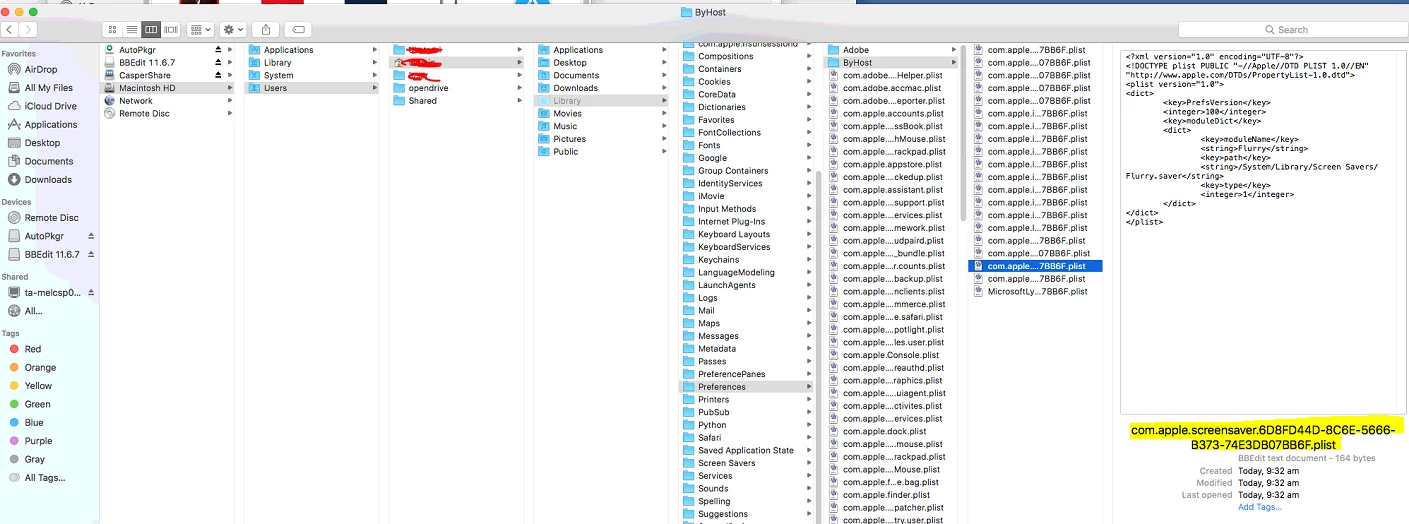

this is how i did it and it worked.
i think your script above is missing the macUUID as part of the plist file.

Thanks for your reply. I've tried including the UUID like you did but the results were the exact same: works manually but not through Jamf. In my experience you don't always need to specify the full plist name.
I'm only needing to read, not write like your script is doing, but I will still try pasting your script in to see if I get different results. Will post back shortly.

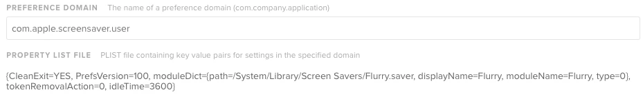

If it's still of any interest..
I created a new Configuration Profile for the Idle time.
I got it to work by referring to this Developer Document: https://developer.apple.com/enterprise/documentation/Configuration-Profile-Reference.pdf
This has a list of payloads for ALL Config Profiles.
So, rather than specifying "com.apple.screensaver.ByHost" I used the folowing user level screensaver payload : "com.apple.screensaver.user"
Works every time!!
