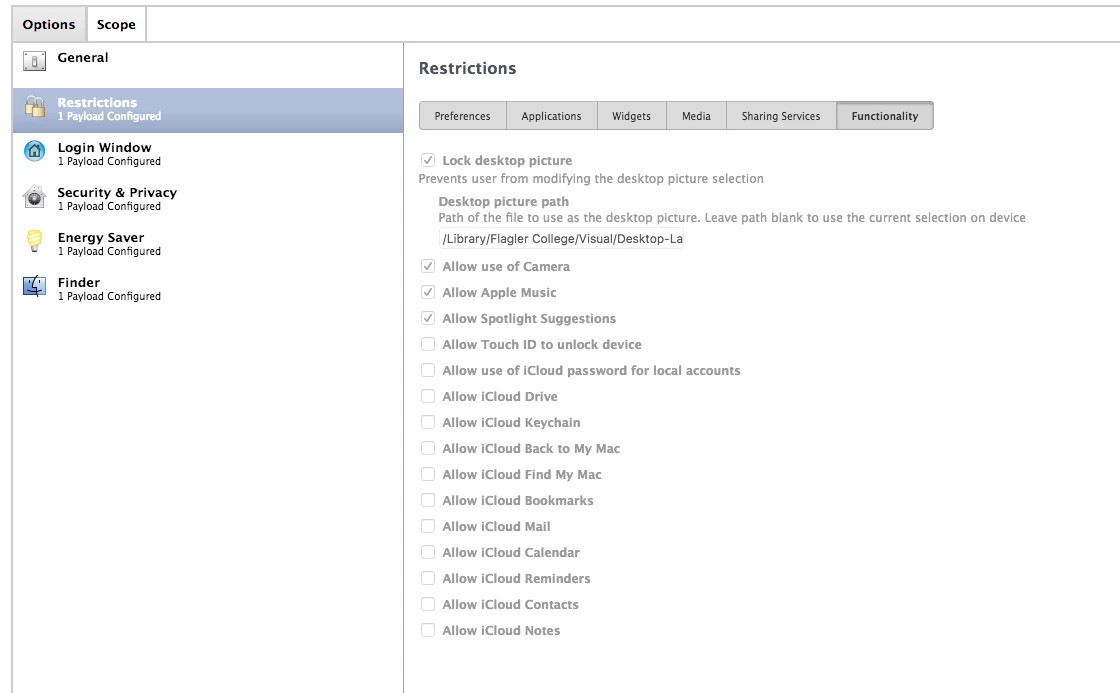

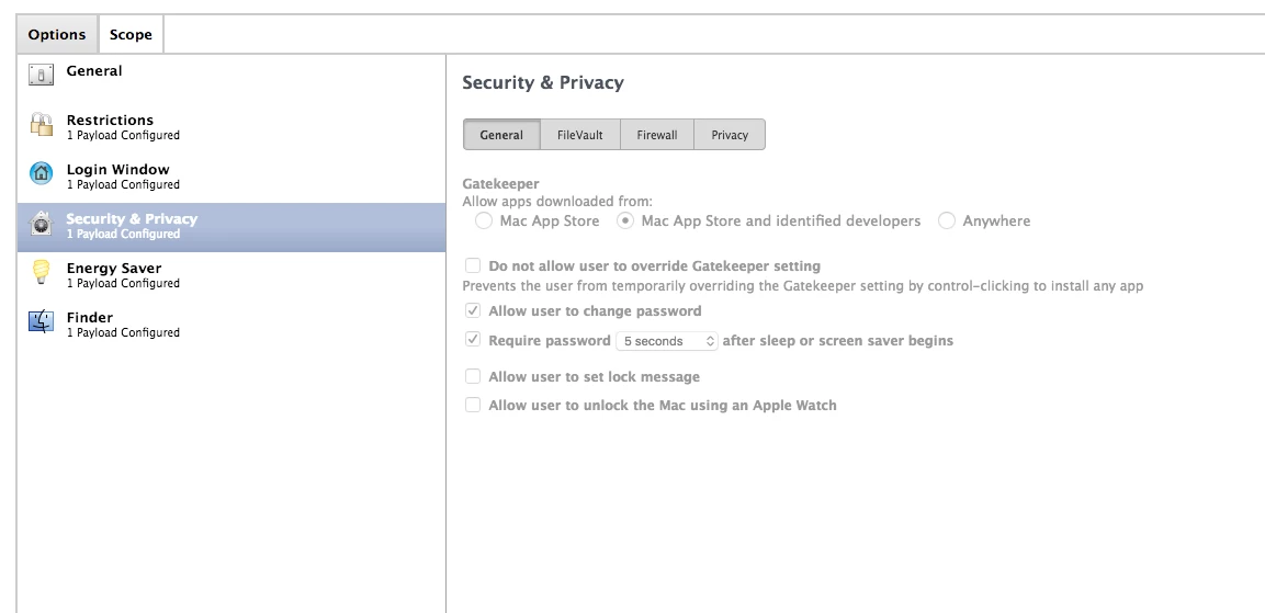

do you happen to have a security & privacy config profile disabling iCloud Drive? anything affecting login window?
http://help.apple.com/profilemanager/mac/5.1.5/#/apd574B481D-3499-491A-8A18-EBDC44E0E0EB
  • August 8, 2017
yes, we have icloud drive disabled.
  • August 8, 2017
Unscope that profile from a few machines and test.

@Caist have you tried with no config profiles installed? There were numerous conflicts with Security & Privacy, Restrictions, and Login Window config profiles that can lead to this exact issue.
https://macmule.com/2016/05/09/icloud-spotlight-login-window-issues-with-jss-9-9-the-security-privacy-profile-payload/
